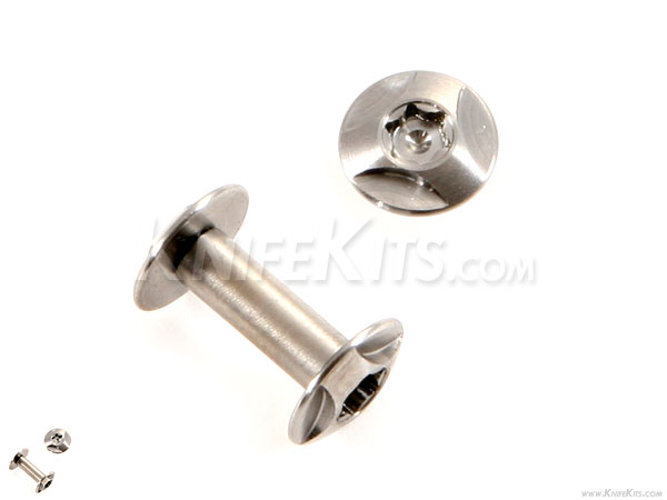

I am looking for the name of the screws used to attach handle scales to a full tang fixed blade. I see them all time on knives but I can't find theverything name to buy some.
They are fastened with ano Allan wrench or similar.
Thank you in advance. My description is pretty bad sorry.
Possible purchase source too?
Called Chicago Bolts, but knifemaker styled may go under another name
These from Knife Kit's
DON
The lower one that Don (Paneraica) has pictured there is called a Torx screw.
You could also search for Corby bolts, Acorn bolts or Loveless bolts. They don't required a special screwdriver and will securely fasten handle material.
