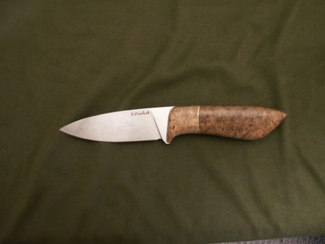

Here are photos of two diffferent knives but my process was the same. I glued up and flattened the maple and teak together as one piece before drilling any holes for the hidden pins. In hindsight I should have swiss cheesed the back half of the tang for epoxy rivets but now I know for next time. Could have used more pins in the back half also. I also do not feel comfortable doing hidden pins on hard use knives though.
before...
After...
