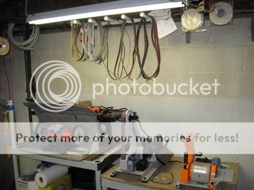

I've had the Delta 1"x42" for many years, adding the HF unit a few years ago, after buying some Delta 1"x30" buffing & sanding/grinding belts dirt cheap at a home center. I use the larger one for coarse, the HF for finer & honing. It does slow appreciably under load. Keep a cottage cheese container full of water near by to keep your edges cool, and a clamp or two on the front will keep the HF from walking. I also use a 6" grinder - with the shields removed and a pair of cotton buffing wheels attached. It's 3450 RPM is too fast - still safe with my wheels (Check your specs.). It buffs fast - using the usual 1lb assortment of 4 oz bars of tripoli, emery, white, and red rouge - Sears did sell it for $4 or so. HF carries some buffing compounds - and wheels, too.
The 3.5" directly driven belt drive pulley would give 3,160 feet/minute for the 3450 RPM HF's motor, ignoring slippage. That's fast - optimum FPM speeds, if I remember correctly, of 1,100 to 2,000 FPM would likely be better. As an induction motor, the HF's speed is powerline frequency determined, thus not a prospect for control. However, while not optimum, the HF units do work... and you can easily spend more on belts than the little tool cost in short order.
