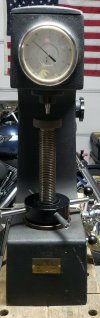

I picked up a very nice HR-150A Hardness tester from eBay about a year or so ago. I got lucky and the seller lived less than a mile from me!
He delivered it, set it up and calibrated it for $500.
I bought a couple of calibration discs and I check it before every use. It's always within 1 point. Best money I've spent other than my oven and grinder...
