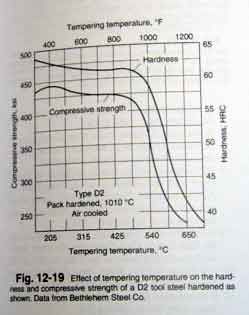

I mean the difference is or isn't enough to feel when we care the blade.
Generally it isn't the hardness you are concerned about as much as what happens to the steel at that hardness. Specifically D2 has a compression and wear resistance maximum at a very high hardness :
http://i7.photobucket.com/albums/y269/CliffStamp/steel info/d2_hardness.jpg
and
http://i7.photobucket.com/albums/y269/CliffStamp/steel info/d2_izod.jpg
with an oil quench + cold you can reach 65 HRC which should make for a very fine cutting knife.
-Cliff

It isn't the hardness which is critical but how it is hardened. D2 has three rough ranges, very low temper of 300F for 62/64 HRC for maximum hardness and wear resistance, moderate at 500F for 58/60 HRC for a combination of properties, and above 950F for 58 and under for optimal toughness. All of these hardness values will be elevated by oil+cold. Most makers run at the intermediate values by default. Mel Sorg used to run at very low tempers, some use the very high ones. You can effect the properties as well by how hot the blade is soaked. In short, don't just look at the hardness.
