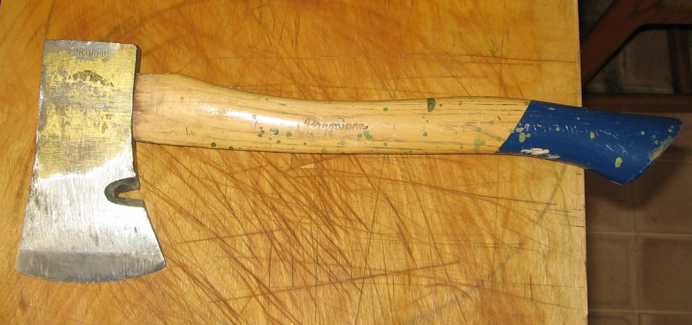

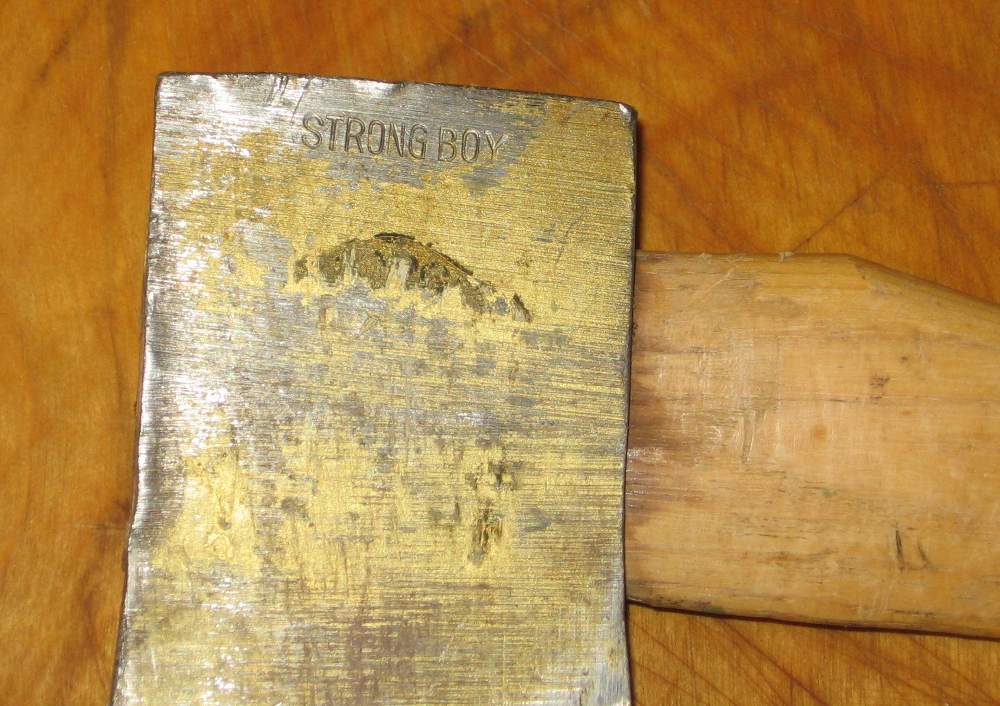

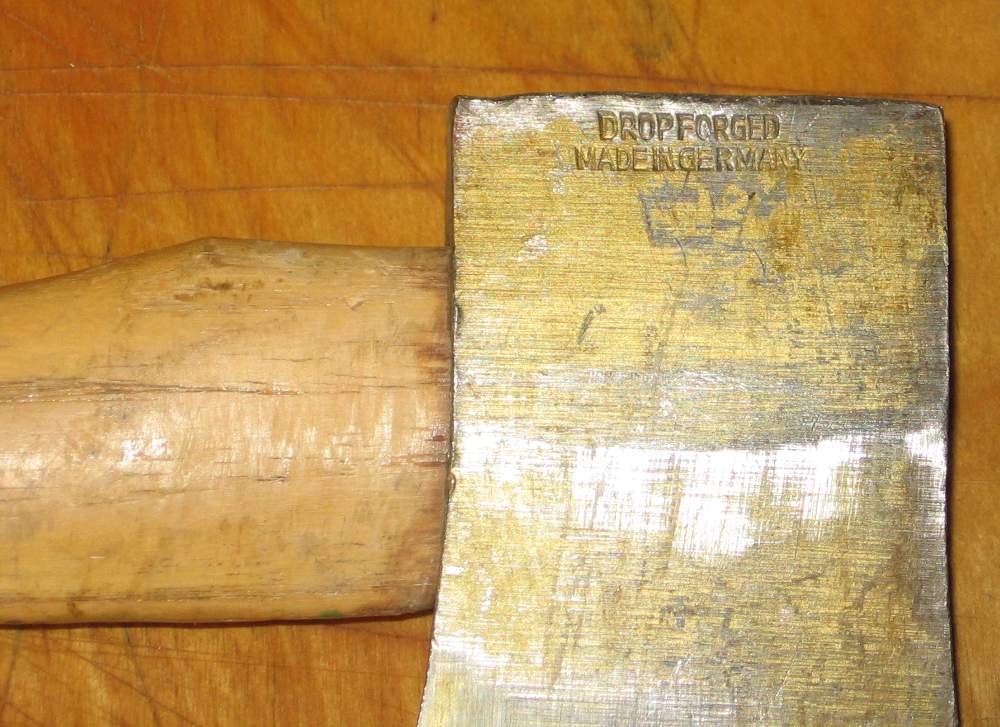

One of my favorite hatchets. Takes and holds an edge very well. Feels like mid-50s HRC under the file. Came with an excellent handle, really nice grip in the swell and perfect grain. Thick cheeks like a typical vintage American camp hatchet.
It is older than unification. Research found it made in Solingen.
So were the krauts basing this hatchet from the American style with a little twist? You can still see a little of theirs in the heel. For better export sales guess? Very nice little axe, and the handle looks like it would fit the hand perfectly, which you have noted already but I felt like I had to say something ha
