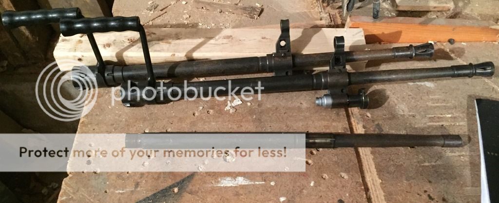

Original barrels- cut of the barrel extension, front sight/gas block/ and flash hider.

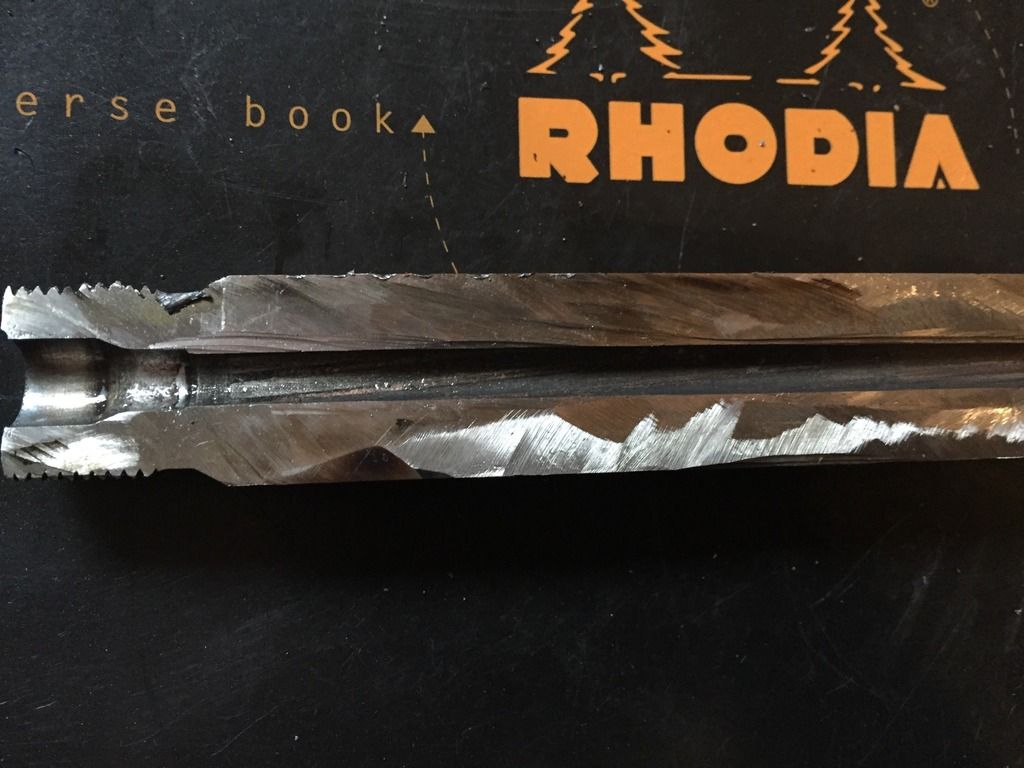

Cut barrels lengthwise to avoid the issue of forge welding the bore, and making the blanks a little easier to hammer out.

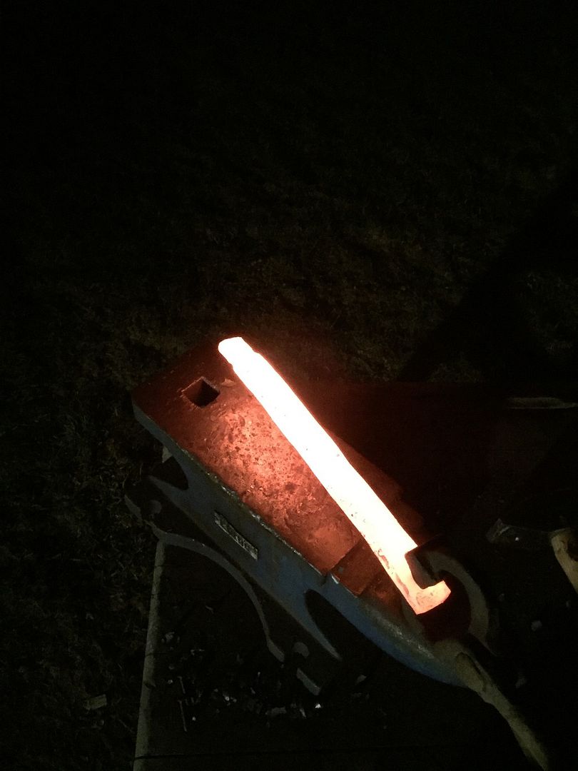

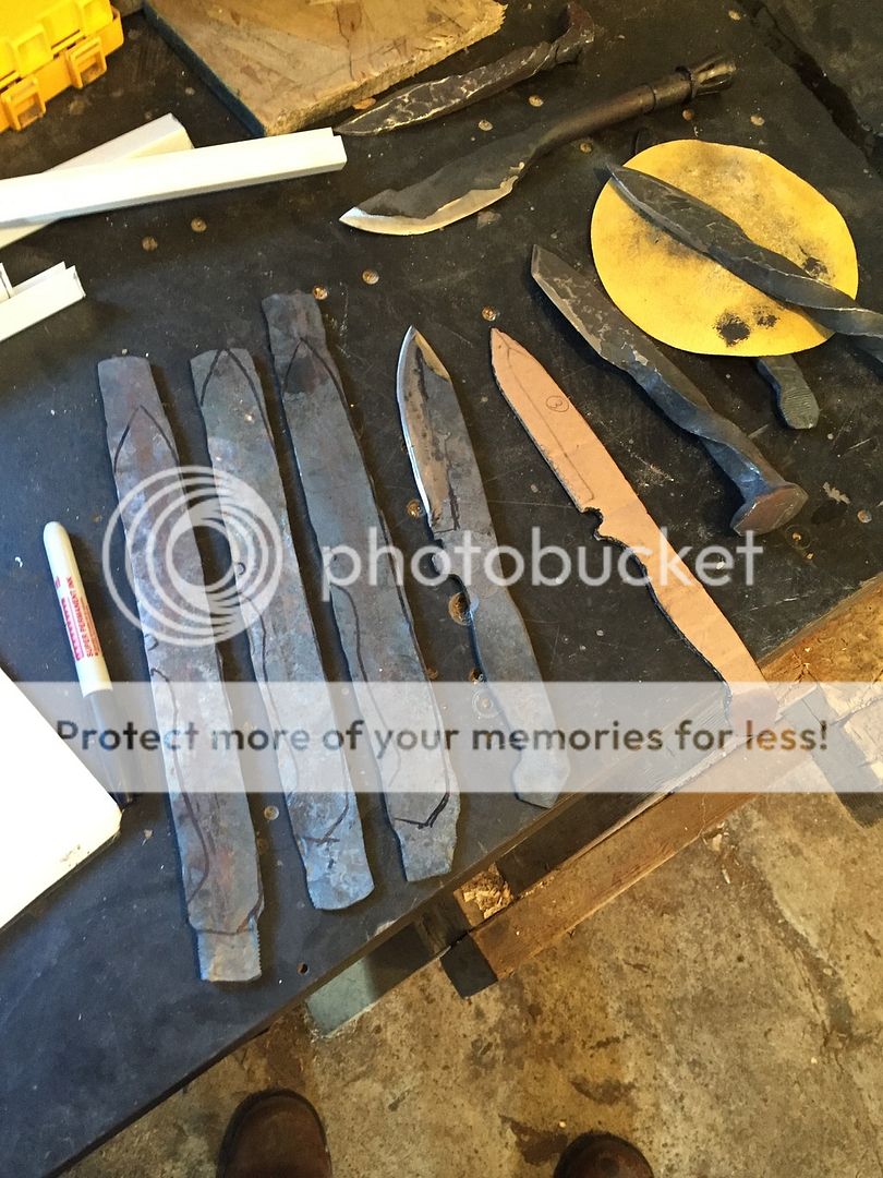

Hammered out into blanks, drew with the stencil and did stock removal

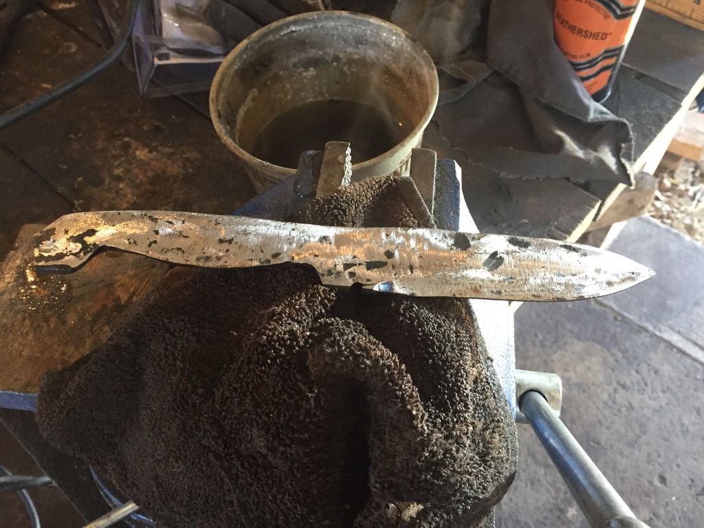

Cleaned the blades up with an Angle grinder
Now I'm doing a lot of file work before the rest of the heat treat. Intending to paint them black with a heavy duty epoxy paint and do a paracord handle wrap.
