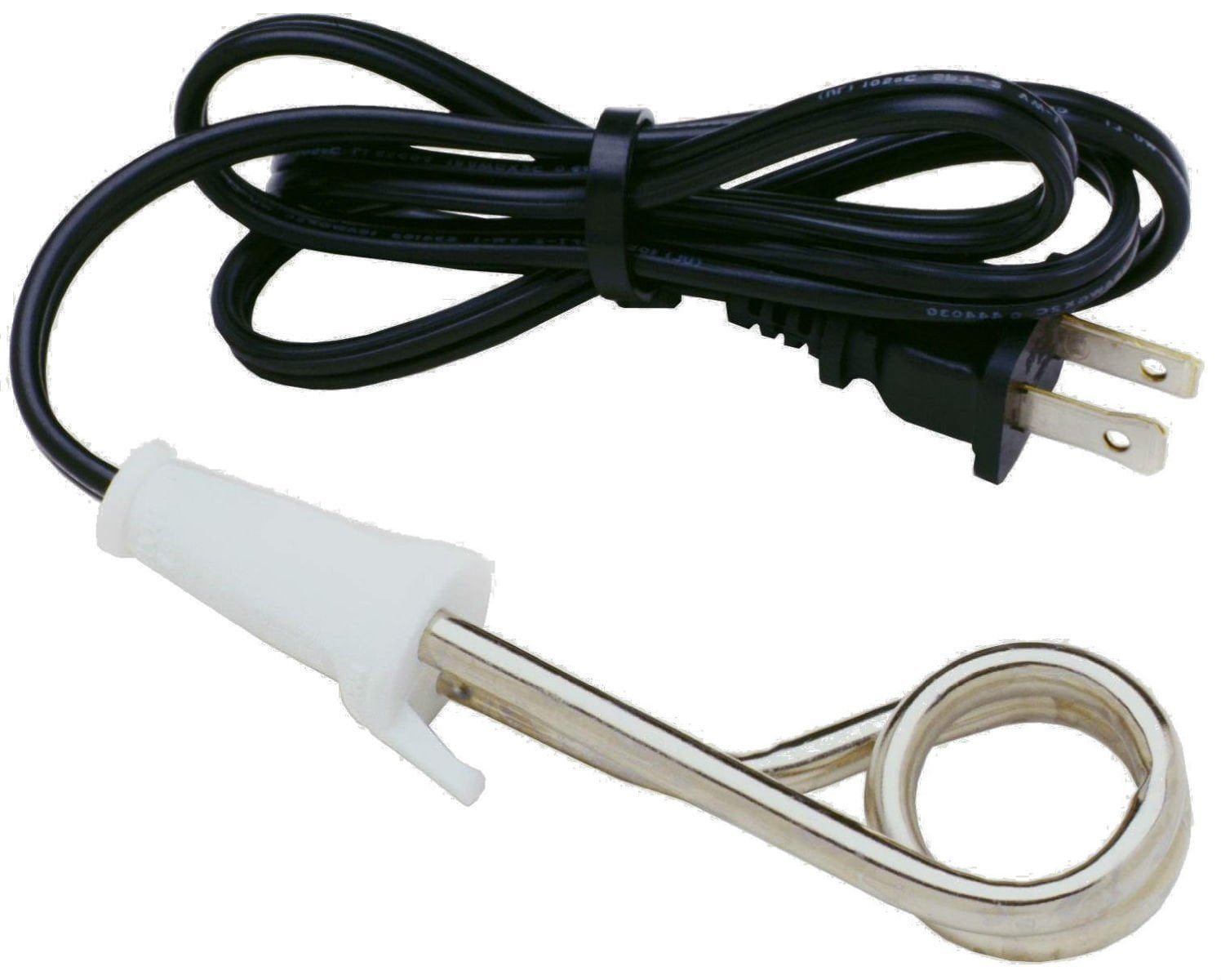

But at $15, a nice convenience. Leave it permanently set to your desired temp and just switch on and off.i use a thrift store fry daddy. fill with water, heat till water boils and thermocouple in oil says 115-120F, get quenching. as far as i can tell, most quench oils seem to perform best at 110-130F. you don't need your oil at 127F+/-1degree, so a pid is just an added expense.
