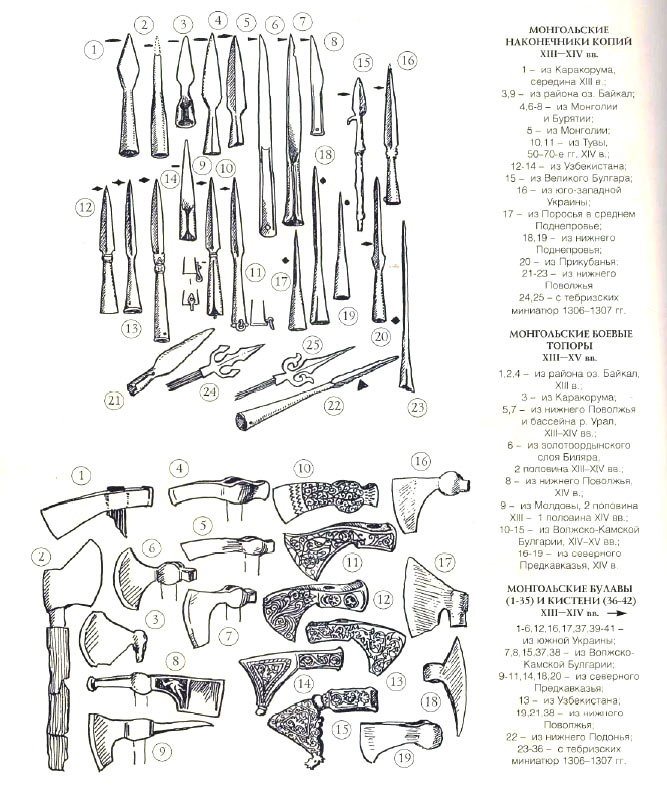

FWIW, the closest historical (presumably) example of that head shape that I found was on this image from a Russian forum (number 2, bottom left):
It's kinda hasty to pronounce this to be an obvious 'fake'. After all it was posted on a "Czech replica-making site". It certainly looks to have 'been around the block' at few times (ceremonies, parades or stage plays?) or the makers have figured out a way to artificially age them. If this thing 'turns your crank', go for it. Just don't also expect it to be able to cut down trees or perform other 'axe-like- tasks that require a tempered blade and a sturdier handle.

Stevel Tall has posted a nice illustration of (mostly) light battle axes from the 13th-15th centuries used by the Mongols and people living in the lands of Tatar Khaganates at the time (Volga-Kama Bulgars, Moldova, today’s South Ukraine). You see the typical fokos-like light battle axes as well as a few heavier axes as well, some with sockets.
My impression of the OP’s piece is that it looks more like a contemporary Pakistani or Indian made fantasy wall hanger, than an accurate replica of a Medieval Central European weapon. I am not saying that it was for sure made in Pakistan or India, just that it looks like one.

The russian schematic in Steve's post #4 though is entirely ....erroneous...(as is evident by inclusion of obvious broad-axes in a table of "military" related objects...).
Russian materials of this sort are Particularly questionable,alas,the archaeology in that unhappy place have long been plagued by politics,lack of funding,misguided nationalism and just plain romantic vision....alas and alack.
