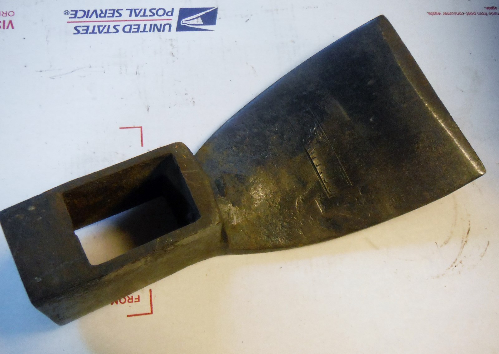

Hello all I am in the processes of purchasing a Collins legitimus adze head. I plan on ordering either the "carpenters adze" handle #3200 or the "railroad adze"#3300 handle from Tennessee hickory to go with it. I am leaning towards the carpenters adze handle but any recommendations would help. I was also wondering how to properly rehang it. I remember reading something that said you don't have to use a wedge which confused me. Any advice would be greatly appreciated. Thanks in advance for your respons

I'd go with the carpenter's adze handle, although measurements of the top of the handle would be useful for comparing to size of the adze eye.
The handles are installed like a tomahawk handle, or a mattock handle: slide the bottom (narrowest) part of the handle through the top of the eye, and slide all the way down until it makes a tight fit (with the eye) at the top of the handle, with maybe a half inch of handle extending past the top of the eye once it's on tightly. Some rasping, filing, and/or sanding of the handle will probably be necessary to make it slide down far enough and fit well in the eye. Holding it upside down (head down) and banging the top of the handle a couple times on a block of wood will help to seat the head on the handle, once it's fitted adequately. The handle can be loosened and removed by banging the bottom of the handle a couple times on the block while pushing the head down.

I could add that it was also customary to wedge the front or the back of the handle inside the eye,to adjust the angle of the tool to the handle.It was done by very practiced users because it gave them the correct(for them)attitude of edge at contact with wood.For a novice it would be pointless,plus,you're not intending to make a living with this,10 hrs a day?Well,it don't matter then.
Adzes had mainly this type,the compression,eye,for unhandling to sharpen the tool,as they commonly had a bevel inside.(the one in the photo needs an edge ground before it can be sharpened).
The tool is used bevel-up which makes it darn aggressive,you want to learn to carry the stroke through.

I would only add that I concur that a carpenter adze handle is what you want. I see a few old adzes with the handle put in reversed. They will work either way but there is a "right" way. A wedge doesn't work well because the socket has a larger taper than an axe and it's made just for a friction fit. You could wedge the side of the handle as suggested above. I've never seen a handle wedged in the center like an axe.
Do these handle makers give you haft dimensions at the eye? Could be railway adze eyes are different dimension from carpenter versions. Obviously you'd appreciate if this fit right from the factory and certainly wouldn't want to find out it was too small.
Your adze is a railroad carpenters head. There were 3 styles of adze handles- house carpenter, railroad carpenter, and ship carpenter. the length was 34-36". Any of the styles should work in your adz, it just depends what you want to use it for. As stated, you do not want to wedge the handle. You only want a tight compression fit on all sides of the eye. If you try to wedge to adjust the angle as suggested you will find that the head will not stay tight very long under hard use. It is hard enough to keep a tight handle even with a proper compression fit when you use the adze hard all day. You also only want 1/4" or less extending above the eye after the handle is driven in extremely tight. Any more above the eye will hit the stick you are adzing on your follow through swing. The follow through is very important to prevent tear out. For a look at the 3 adzes and their traditional handle shapes look at page 13 of "An Ax To Grind"

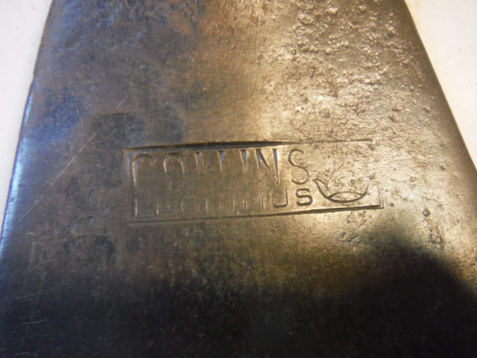

Thank you guys for the information. Did I do well in choosing an adze? I was really excited to find one with the collins legitimus mark because most of the adzes on eBay have no mark or a mark I have never heard of.

My adze just arrived and its way bigger than I expected. It's 9 inches long with a 4 1/2 inch cutting edge. I'm now leaning towards the railroad adze handle.
