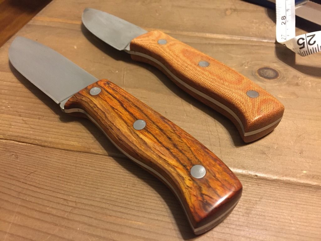

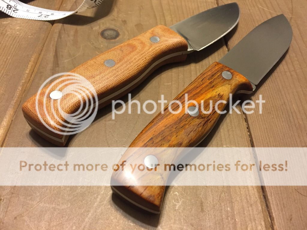

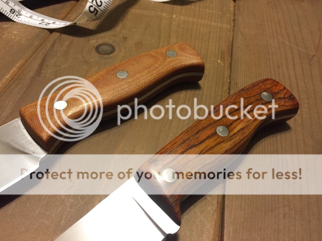

Hey guys, I recently tried using some cyanoacrylate (super glue) to fill in the grain on a piece of cocobolo. I am wondering if I'm doing this correctly. Here's what I did. I rubbed a single coat on the entire handle (sanded to 800grit before the CA glue), let it dry about 2 minutes. Then, I went back to 400grit and progressively sanded up to 1200 then buffed. It came out really nice and glossy with no more grain. However, there are (barely) noticeable places where I sanded through the CA glue. So, my question is do you guys usually apply several coats of CA? If so, how many? Do you just apply several at once, or one coat, then sand, then another, or what? Do you oil the wood before CA? Finally, to what grit do you sand before putting on the CA? I think I'll go back and do another coat or two depending on what you guys say, but I'm really happy with the results. The only thing I'm not LOVING is that since I didn't oil the wood before the CA, fearing it would not stick after oil, the wood is lighter with less red tones than I had wanted.
And since a thread is so much better with pics, I'll put a few below. The one in question is the Cocobolo handled blade. Pay no attention to the micarta knife. Also, to those that recommended that I thin out/better contour these two knives in my other thread, thank you. I took your advice and they feel much better, despite me THINKING that they already felt perfect. Someone in particular told me to make them egg shaped in profile. That's what I did, and I love it. So, whoever said that was spot on.
Thanks again for all the help!
