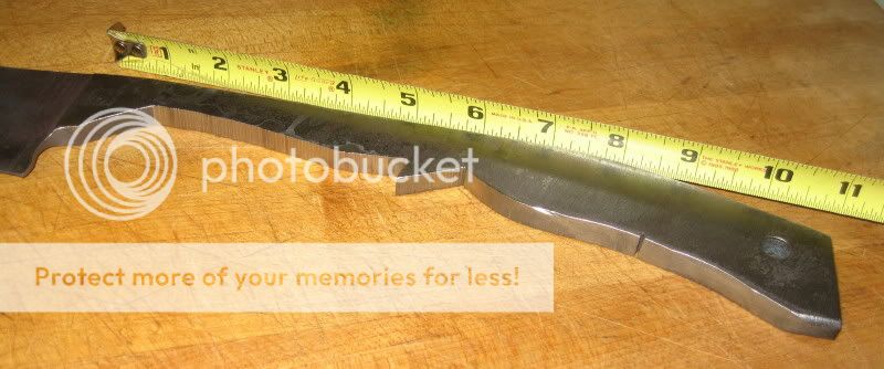

The blade that came with my bandsaw lost some teeth in a fight with a leafspring today
. Question, some say they buy blades at home depot, the Ridgid bi-metal. I looked online and they say they have 62 1/2 x .025 x 1/2", the manual says 64 1/2" do they have the right sizes at HD? I'd like to get them today instead of waiting for shipping.

OK, went to HD, bought a blade, they had the right size at 24 teeth per in. It cut a total of 1 1/4" before it was a goner. I had annealed this properly I thought. Last time I went camping I cut up a whole bunch of springs and threw them in the campfire and buried them in the coals overnight and they were still warm when I got up the next day, wouldn't this work? It was a blazing fire and they got to non-magnetic and cooled slowly. Is it the blade or a crappy annealing job? It grinds nicely, are the blades really that crappy? I put it in the forge tonight after burning up the blade to anneal again. The Harbor Freight blade outlasted the Home Depot blade by 10 blanks and a bunch of other stuff I had cut.

there's _no substitute_ for proper bi-metal blade. Good all around blade will have 18 tpi (13 is more aggressive cutting, but it will loose teeth quicker). McMaster, Enco, MSC are some of the huge, reputable suppliers that always stock these in all sizes.

if you had not annealed the spring, i'm guessing cutting through it at all with a bandsaw blade would have been completely impossible. Unless you only somehow managed to anneal part of it
OK, was going through steel cutting withdrawals and had to have a blade so I returned the Home Depot blades that fried and got a bi-metal 18 tpi blade for $15 from Harbor Freight until I get my good blades in the mail and it cut right through the spring like nothing, no telling how long it'll last but I got what I wanted to do done. Steel is 3/8" truck spring. The little cut towards the back is how far the Home Depot blade got. Thanks for the help.
