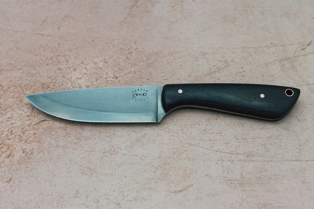

here's some white steel 2 that I forged and finished up this past weekend
I don't have alot of experience in forging as I'm still learning
but you can search for my recent Hitachi steel WIP if that helps

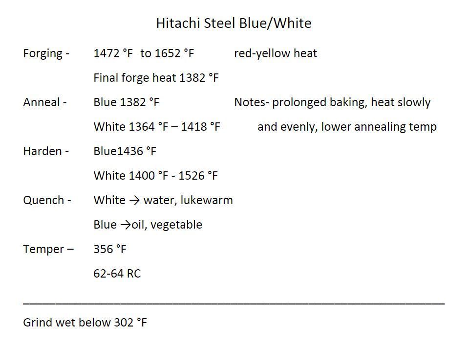

here is a guide I made for myself, for forging only
anyone can use it if helpful or modify it for your needs.
it's just the same data from the sheet that comes with the bar of steel and some notes for me
IIRC, I use 1450F for austenitization, and get Rc 60-61 with a 400F temper. The Hitachi specs from the sheet that are posted above are great for fillet and sashimi knives, but I think they are a bit too hard and chippy for most blades. The san-mai will be most likely used on working blades, which need a tad more toughness.
