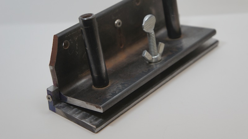

Just wondering what people use to hold small folder blades when grinding?
Bare hand seems to lack control and leverage. Vice grips will mar the ricasso. Pictures would also be great.
Thanks.

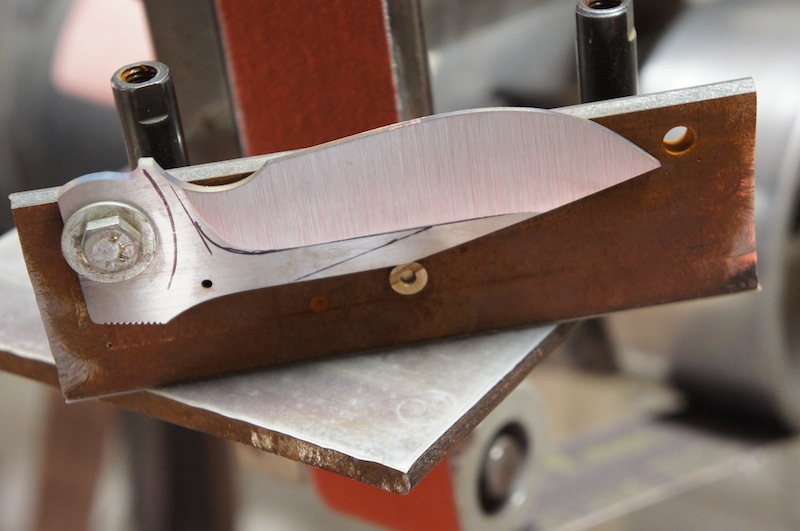

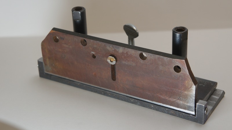

These are some pictures I've seen of Tom Watson's jig.
I think I remember he ground blades with something like this too:

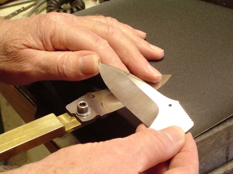

Don: The last photo looks good. Don't need/want a jig, but that last handle looks promising.
