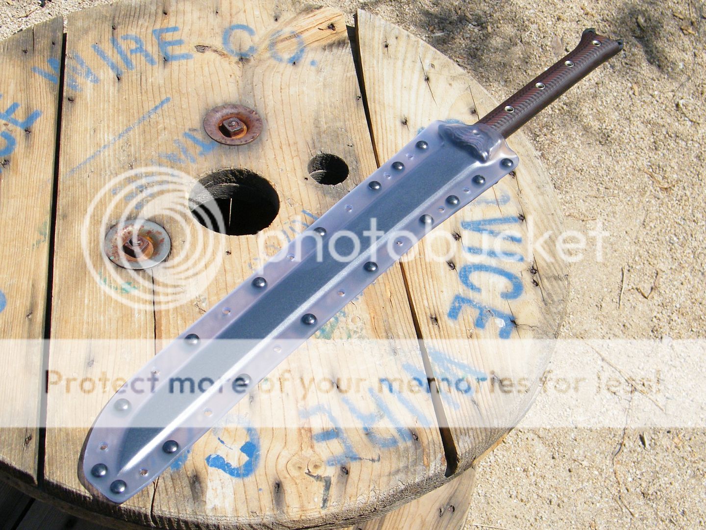

I have made a couple sheaths from Holstex.IMO it is a little harder to work with.I heat it hotter than kydex and when heated it has more of a rubber feel.This makes it harder to get the item being molded in just the right spot to close the press on.
Here is the one I did for my Boss Jack,the fit came out great,seems the be not a hard on a finish as kydex.
