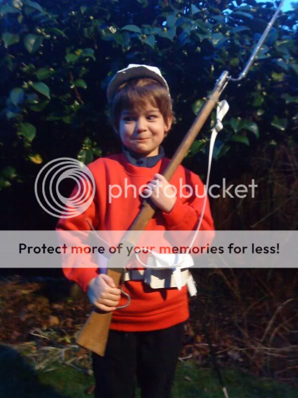

My 5 year old son hasn't really got any toy guns so some time ago, I decided to make him one. I got a rather rough piece of board and drew the outline of a rifle in 2/3 scale on it. I chose the Lee Enfield number 1 mk3, as used in WW1 and they early part of WW2.
I just quickly cut around the outline with a jigsaw and roughly rounded off the edges with a spokeshave and a rasp. Then I painted the metal parts black and stained the wood parts dark brown though to be fair there is a bit of overlap! All in all probably took just over an hour, a lot of which was taking measurements from a picture and converting.
The youngster has had a lot of fun playing with the end product to the extent it is now getting a bit knocked about!
Recently he has become infatuated with the film Zulu, so I decided to make a 2/3 scale wooden Martini-Henry, but try to do a better job this time.
I found a nicer piece of planed softwood board and drew the scale rifle on it in the same way. Then cut round it with the jigsaw but I spent a lot more time rounding out the shape. The trickiest part being the angle where the barrel is set into the woodwork on the real rifle. It is a lot less than perfect owing to the graininess and knottiness of the wood.
I then painted the metal parts in grey watercolour (2 coats) and for the wooden parts I made a dilute brown wash to try to stain the wood darker. I then polished it overall with Briwax.
I made a separate trigger guard from the tinplate from a food tin but it is very thin and I'm not happy with it. Also I haven't yet fitted a cocking lever or cleaning rod end. I'm trying to think of a simple way to make a moving cocking lever.
The sling is 1" white nylon webbing, the originals were white leather I think.
The sling on the SMLE is a genuine WW2 Sten gun sling, 7/8" wide as opposed to the 1 1/8" Lee Enfield one, so roughly in scale.
Anyone else had a go at making their own kid's toys?
Those look great. I am sure he will have a great time playing with them. Much better looking than the toy guns I had.

Wow....those are nice.

PS Re cocking lever. An outdoor gate bolt should work for the Lee Enfield. Scout around the market stalls for somthing for the Martini Henry. The best fun a father and son can have.
I was thinking of altering a gate bolt to fit the Lee Enfield but it would take some altering as the handle of the rifle bolt comes back a long way and most of the supporting flat metal of the gate bolt would have to be cut off somehow so it would fit widthways.
I've seen a metal curtain pole bracket that is not too dissimilar to the Martini cocking lever:
but I'm still pondering a way to make it actually move up and down. I don't have access to welding gear.
Maybe pin in the front for the pivot and add a spring between the stock and the lever. He could pull it down to 'reload', but the spring would snap it back and hold it into place. You would have to make a hollow pit to house the spring in the stock.
