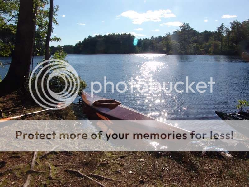

I finished my kayak... sort of. It still needs deck lines and a couple other little details, but it's now seaworthy. It's a wood frame covered in nylon and a two-part urethane. I couldn't get to the ocean today, so I launched it on a lake.
The morning was rainy, but by the time we got out, the weather had become beautiful. Caught a turtle, but no we did not eat it. Went swimming. Found blueberries. Basked in the sun. Paddled.
very nice kayak, looks great.
looks like a nice time. good that the weather turned good.
Thanks guys.
By the way, the boat is a joy to paddle. I'm very happy with the result. Can hardly wait to let it hit the waves.
Wow, that turned out really good. Looks great, good balance. How does it track ?
Did you build up the coaming from blocks or laminate it from strips ?
What's the final weight?
Looking forward to the review after it's seen some chop !
Nice job.

How's it track? What's it weigh? How tough do you think the fabric is...will it take some moderate abrasion? Bump OFF a snag?

Tracks beautifully. I was a bit concerned when I noticed it veered a tiny bit to the right when I stopped paddling. Then I stopped paddling with my stroke on the other side and it did the opposite to the left. This is very, very minor and will be taken care of once I put the rub strip on the stern.
Coaming is two pieces of 3/4" plywood on top of one another, the top piece overhanging the bottom by 5/8". Final weight is 30 lbs - about half of some 14' plastic kayaks selling for a thousand bucks.

The fabric is extremely durable, it's already taken quite a few bumps and sharp sticks without any issue. The secret is that the fabric has been coated with a two-part urethane used to glue cement slabs for highways. I finished applying it on Saturday, and some of it is still stuck to my arms and hands. I'll add a rub strip on the stern to add to tracking and make it safe to drag along sharp rocks. I'll definitely check out Nanook of the North. It's probably online.
