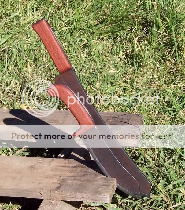

Here's a homemade machete, and a small utility knife I wear on my belt. I can't remember for sure what steel I used for them, but it was probably some big bandsaw blade.

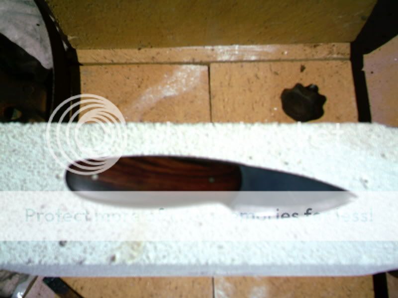

The first one I've made. Crappy pic, but oh well. 1/8in 1080 steel, cocobolo handles and NS pins. I'm currently working on the second one, that will be for my wife, and the design is much improved, I can't wait to get it done.

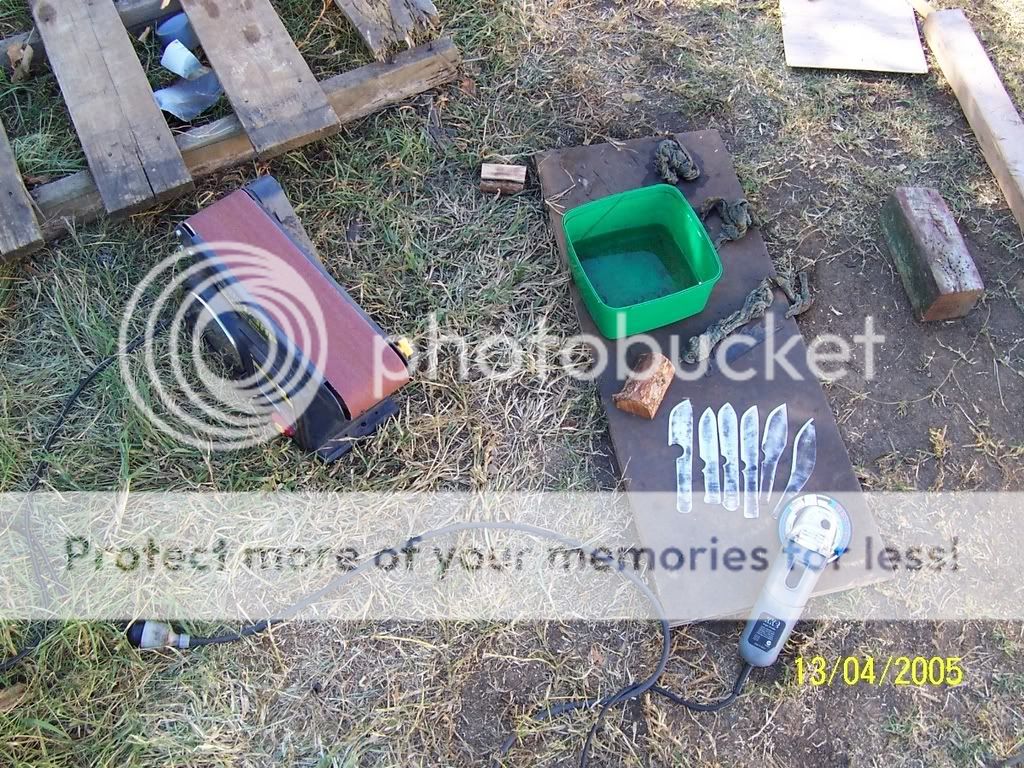

my knife making workshop in full swing

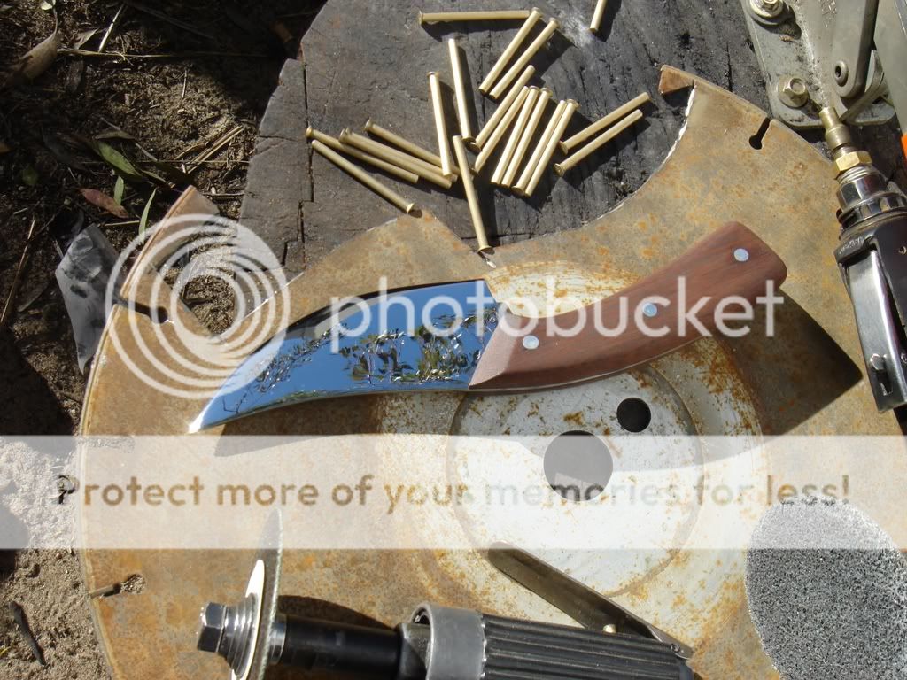

Here is one I just made for a guy at work.
The steel is a circular brick saw
.090 thick
edge quenched with a torch and oil
Jabrock scales
White plastic liners
The same metal with Jarrah Scales
