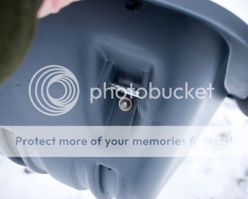

This year, I came across a Pelican sled that seemed to be perfect in every way.
My project is not quite done, but I wanted to share it anyway.

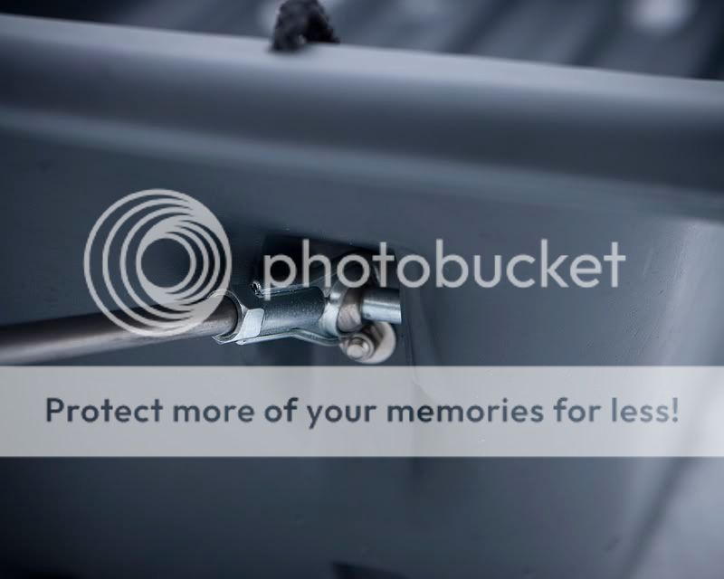

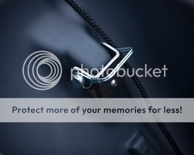

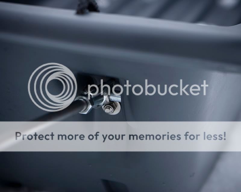

The sled already had recessing for attaching to.
I might go more sophisticated next year or so and try fiberglass rods, or whatever. But, for an experiment, I wanted to keep it cheap. And there is approximately $12 into this setup.

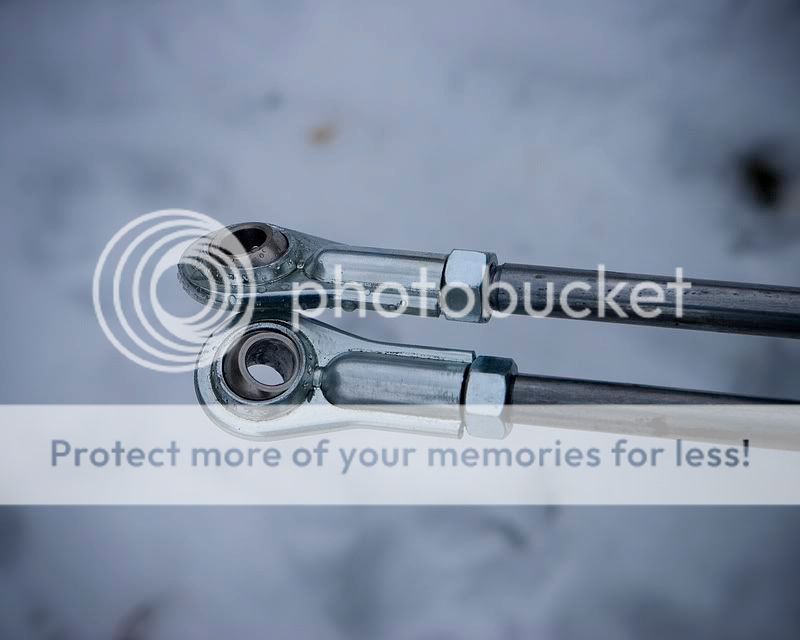

The rod is simply 10mm steel rod. I chose 3/8 swivel rod ends.
The non-matching rod size is because they were readily available. Most of the work was done by NWA is his shop. He turned the 10mm rod down on a lathe and then threaded to take the 3/8 ball end.

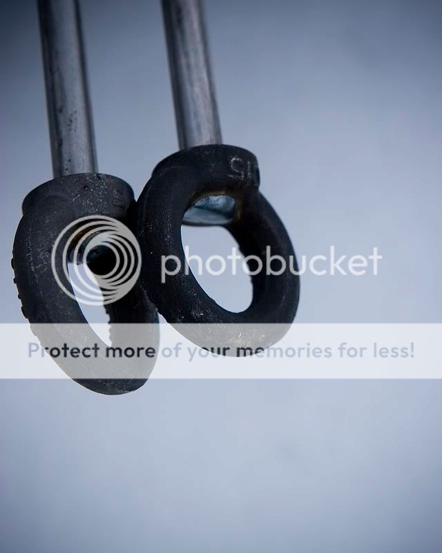

On the waist belt end, we simply threaded it for two eyes, and Nick tack welded them on.
Possibly a bit overkill, but I wanted to reinforce the attachment area so that I was not pulling on plastic. This was done by grinding out a shape from steel tubing.

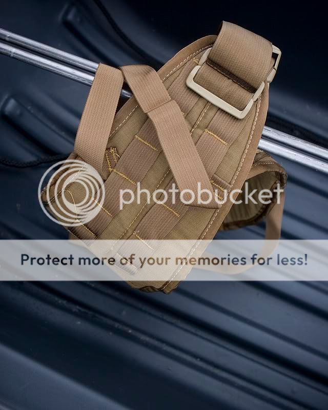

For a belt, I decided to use the waist belt off of my Kifaru express, as it is already a super comfy belt.
As you can see, there is enough molle to rig up a nice attachment system, and I will. For my trial run, I simply tied the rod eyes to the belt.
I do not want to carry more than a daypack anyway. If I need to carry more, I don’t want it to hurt my snowshoe floatation, and it will go in the sled. I am hoping to rig this belt up to make it work with or without the pack, depending on my intended use.

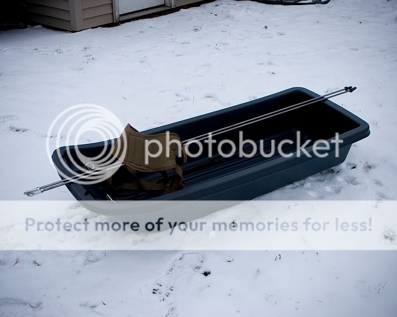

Here is the final rig up.
Now, my intended use is for snowshoe backpacking. However, I know it will spend more time hauling the kids around : ) So, I will end up using it for everything from ice fishing, walking to the sledding hill, dragging the kids through the neighborhood in winter, and taking them hiking when it is too far for them to walk.

What kind of store did you get the hardware from? Lowe's, Home Depot, or some specialty hardware store? I looked for "swivel rod ends" and could not find them on Lowe's or Home Depot online.
Try searching for heim joints. I'm pretty sure my local Ace carries them.

Most pulks I have seen are belts only. Using it, I am not sure what shoulder straps would buy me. If it does indeed help, then I will just attach the rest of my day pack to the belt (which is my plan anyway). It has aluminum stays in it anyway. I would like to carry a small amount of stuff on me (hence daypack and not a multiday), and still pull the sled. Will see how that works out. Here is the back that goes with the belt.

The sled is not actually that short. It is about the same length as the paris expedition, but I think the depth is just making it look short.
I like the deeper sled because of the snow. I usually use these here in Michigan, and not many people seem to do this. So, it seems like you are always breaking trail.
In deep snow, the shallow sleds can take on snow easy, and actually carve in to some while turning. The obvious solution is to just use a cover for your gear, fit to the sled. But sometimes that is just not always possible. Just personal preference I guess.
