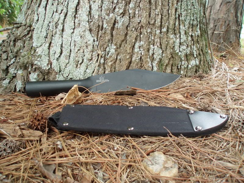

Specifications:
Weight: 9.8 oz.
Blade Thickness: 3/32" (2.5mm)
Blade Length: 7"
Handle: Hollow
Steel: SK-5 High Carbon
Overall Length: 12 1/4"
Sheath: Cordura

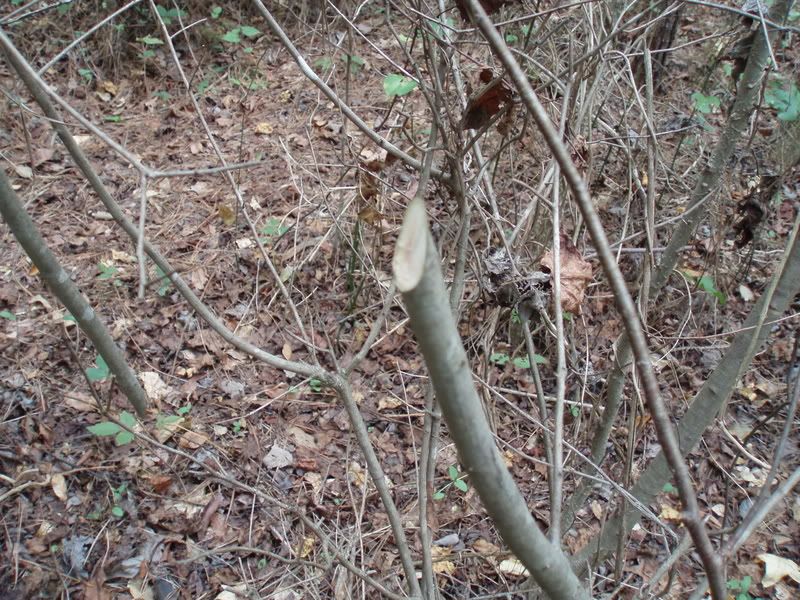

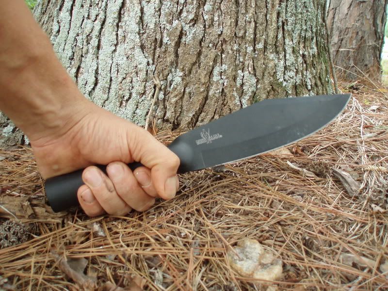

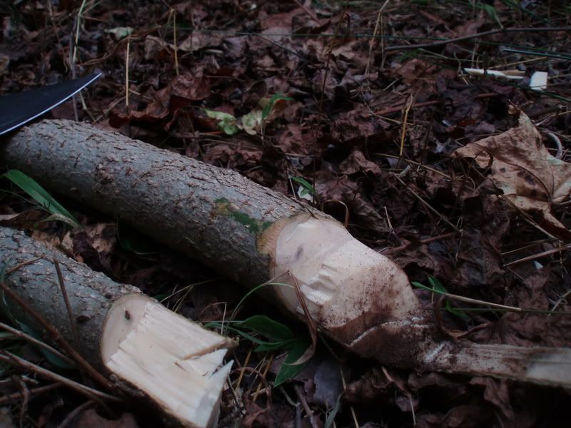

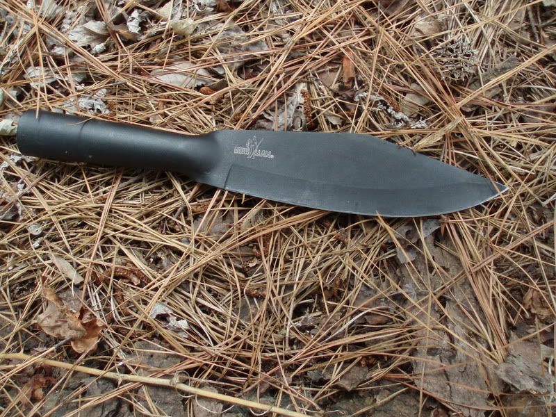

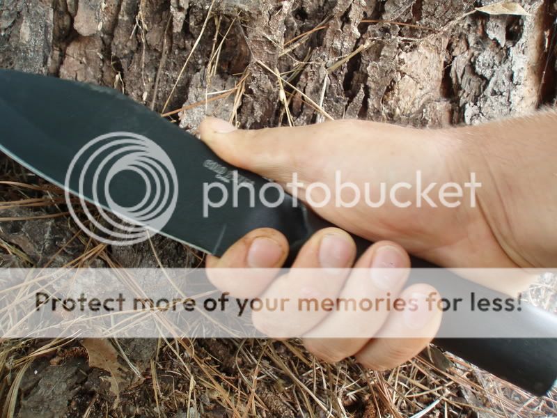

The knife boasts a heavy 9.8 ounces., due to the metal in the handle (think of it as almost twice that of a full tang, if sandwiched together). The blade thickness: 3/32", gives this knife plenty of flex, yet still performs as a lightweight chopper. I don't think this is too thin to baton, and I wouldn't doubt the Bowie Bushman for a second if used in this manner. I'll speak more of the thickness later. The blade length is about 7", the normal size for most "combat" knives. This utilitarian size together with the bowie style blade makes for an interesting outcome.

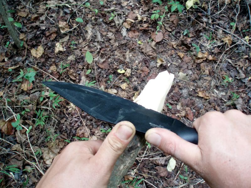

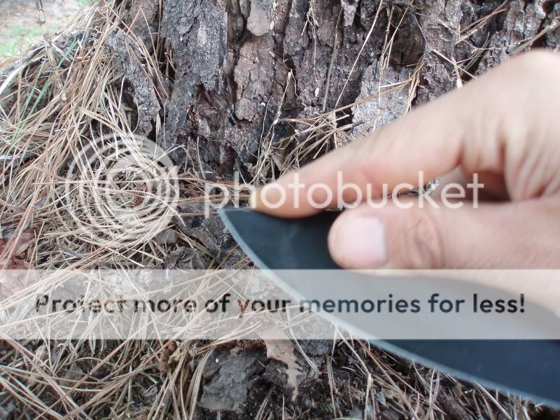

The knife was comparatively sharp when it came out of the box, and with few swipes on the ceramic rod, it was screaming scary sharp. The SK-5 High Carbon Steel edge was an ease to touch up and re-sharpen throughout the whole process, and took to scary sharp within seconds of touching any fine abrasive. This might be attributed to the rockwell of 54, a little on the lower end of the spectrum. Could one possibly pick up a river rock and hone the knife fast in a pinch? You betcha! This also make sense from a more primitive situation standpoint, where one might not have the greatest sharpening systems, belt sanders, or strops lying around. (such as in a third world village). Outside sources equate this steel to 1080 or 1095, two steels which, in my book, are first choices for use outside in a long term field situation. The knife even threw sparks for the fire steel, despite the coating! It was a little awkward as a striker at first, but with some less traditional holds, it got the job done well and threw sparks like a cheap Godzilla movie. The hardiness of this steel really showed its true colors in the throwing test I decided to perform.

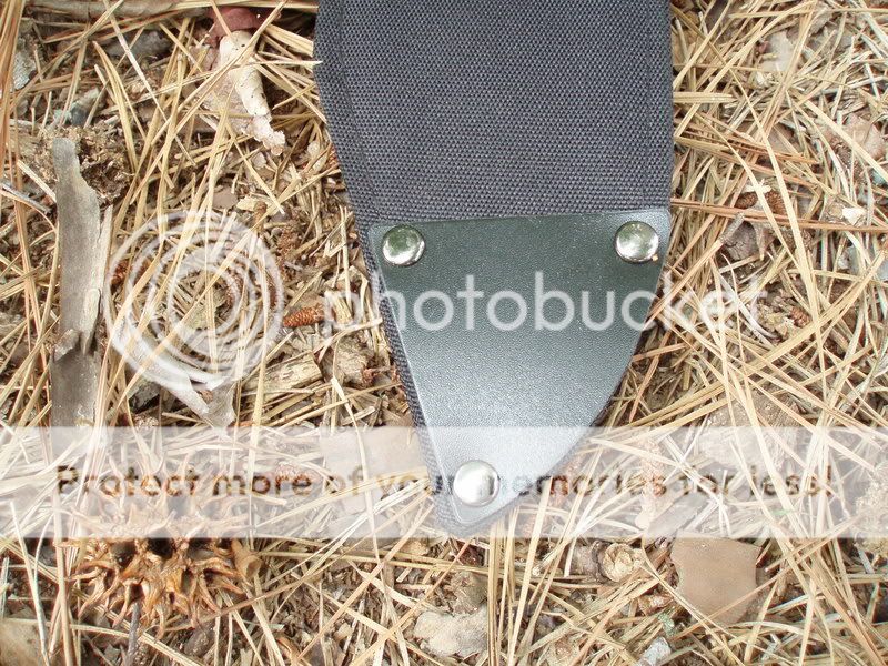

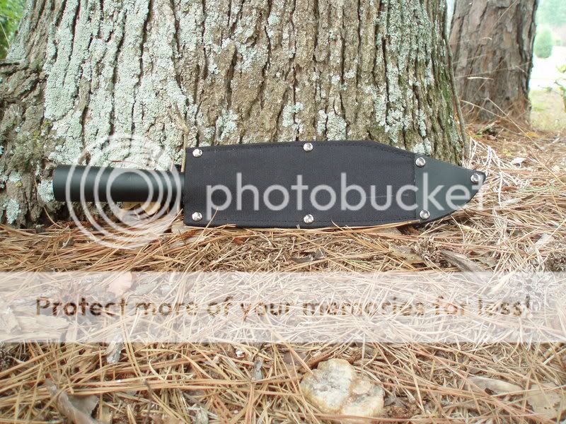

The sheath could use an upgrade, with single stitching on the sides that seemed to be loosely bound. The belt loop is just a piece of nylon webbing, and is not a tight weave. The end of the sheath sports a type of plastic triangle on each side, near the end. This does not wrap around, and looks to be the consistency of a plastic binder that one would find in grade school. Certainly not the nicely textured features or the rigidity of kydex. Additionally, the sheath would routinely dull the knife when pulled out. One could easily construct a more expedient sheath out of 2" PVC pipe heated in an oven.

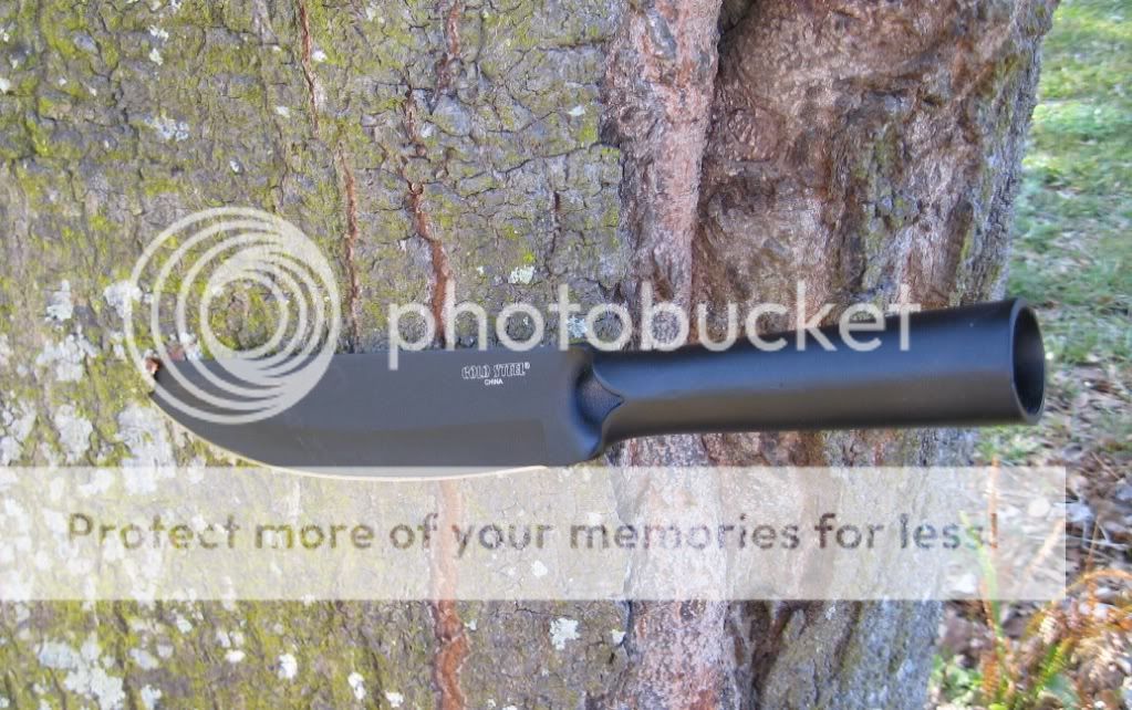

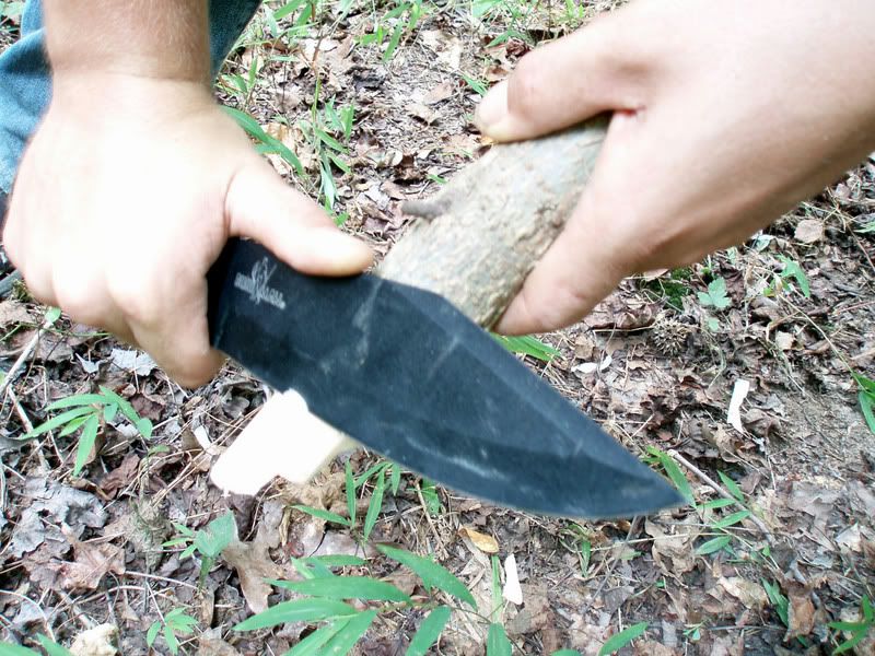

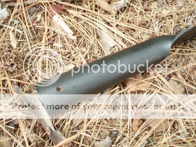

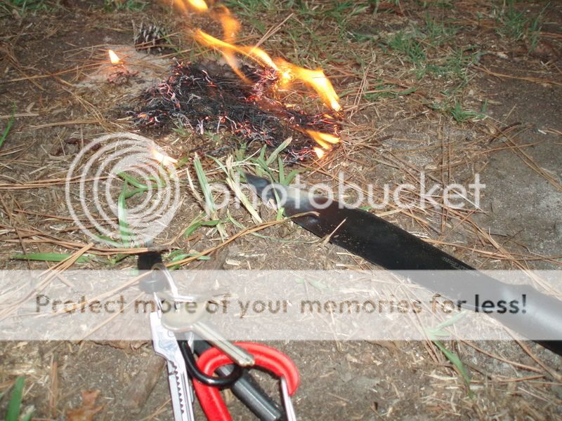

The handle was a novel tapering tube, the basis for the simplicity, style, and ergonomics that make up the bushman knife. One of the first things I noticed with this particular bushman was that there was no weld line where the tube sides were rolled together. I thought this was a nice touch, as it gave the illusion of one piece of solid steel. The coating over the seam was a nice touch and conformed to the hand without any distinctions. The handle proved itself with extended use over time. No blisters or wrist aching to speak of. The handle opening is about 1" at its widest point. This would easily accommodate a sapling or small ash shaft should you decide to take up joisting or something similar. More talk of that down below. The space inside could hold a wonderful small PSK and could be stuffed with all sorts of goodies. I easily put a small fishing kit and 100 feet of 50lb braided spiderwire in mine, coupled with a small Spyderco Ladybug. The knife is a little handle heavy, but as any tool would go, you would easily get used to it with use. At the point where the handle melds with the blade, there is a small swell that makes it comfortable to choke up on, right before the blade starts, for fine work. While my thumb didn't rub at all, I could see myself sanding it down later just for a better fit. Trap triggers were easily whittled. The heavier handle was interesting to hold near the end of the knife. When doing so, this made for a more formidable chopper, and I was able to take down a small oak tree with it. It worked well for smaller vines and stuff that got in my way, the lightness of the blade made me think of some of the thinner machetes out there. The flat blade worked well for pounding pegs into the ground.

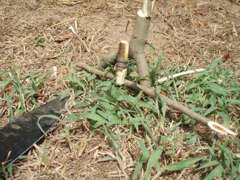

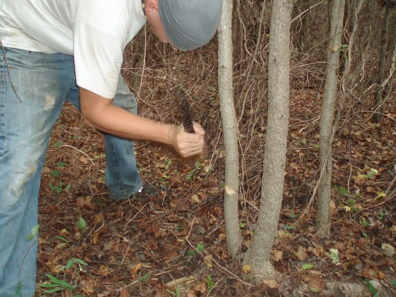

Making traps:

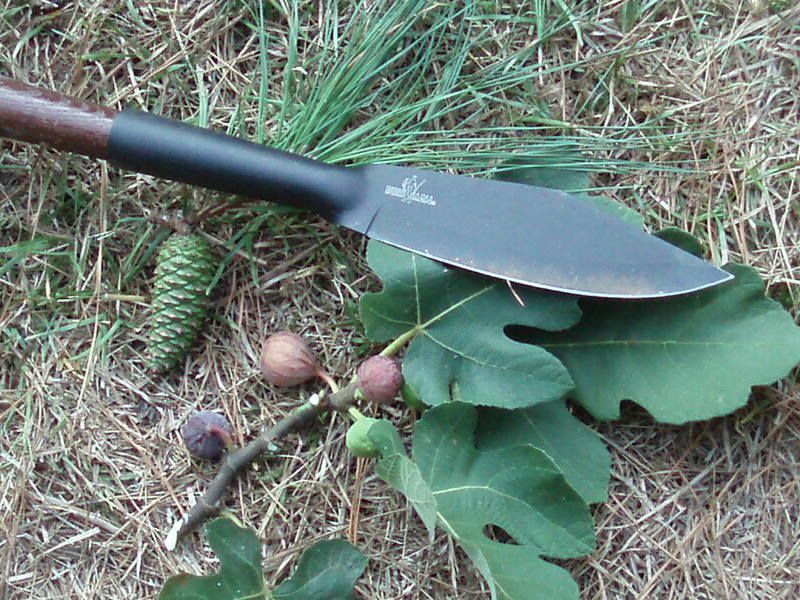

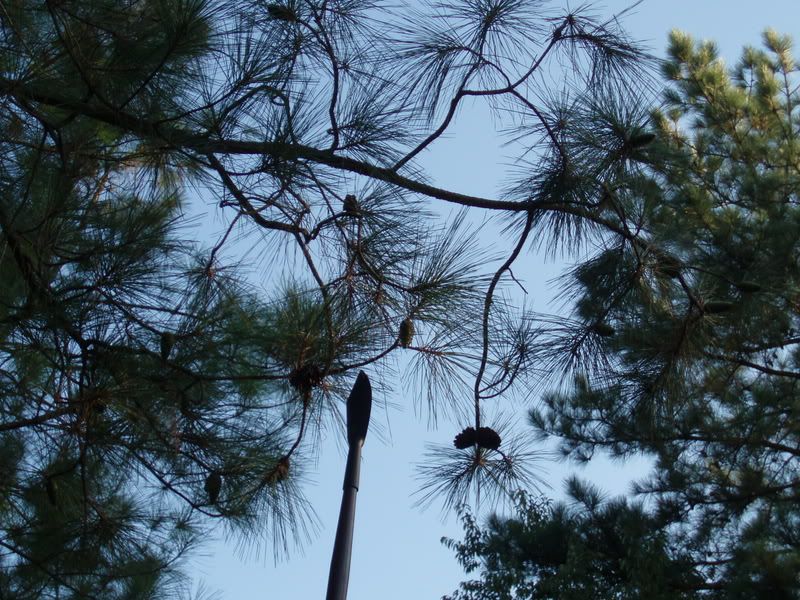

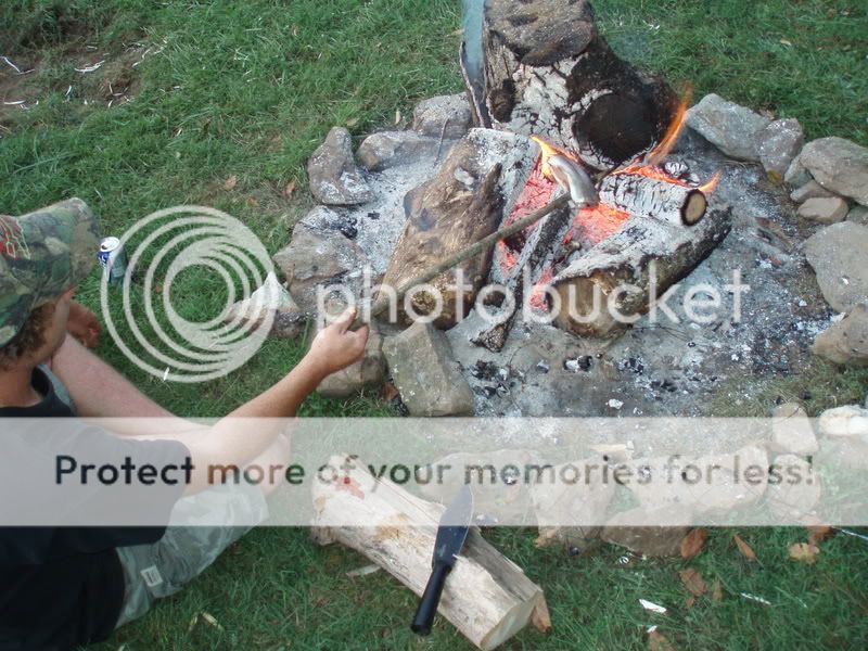

Though most frown on mounting your knife to a shaft, one could easily do so with the bushman. The handle is round and about an inch at the widest diameter. One can easily affix the blade to a tapered sapling or staff to make an expedient field spear. Why would one want such a tool?
The obvious answer would be defense, or perhaps hunting. In defense, it would be a formidable weapon against bears, alligators, zombies, or other creatures you wouldn't want to get up close and personal with. If you were hunting such animals, this would also be the case.

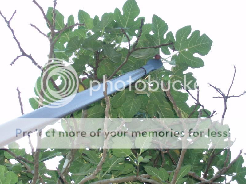

However, there is another largely over looked benefit of having a sharp blade mounted on a long staff. Sometimes one may want to forage for items in hard to reach places. I was able to get to the top of my large fig tree, where the succulent figs had evaded the onslaught of deer and other foragers. With the knife affixed to the elongated handle, the user can easily trim off nuts and berries that they could not reach by hand. I easily cut a high branch to get to this young pine cone, which could have been heated later to extract pine nuts.

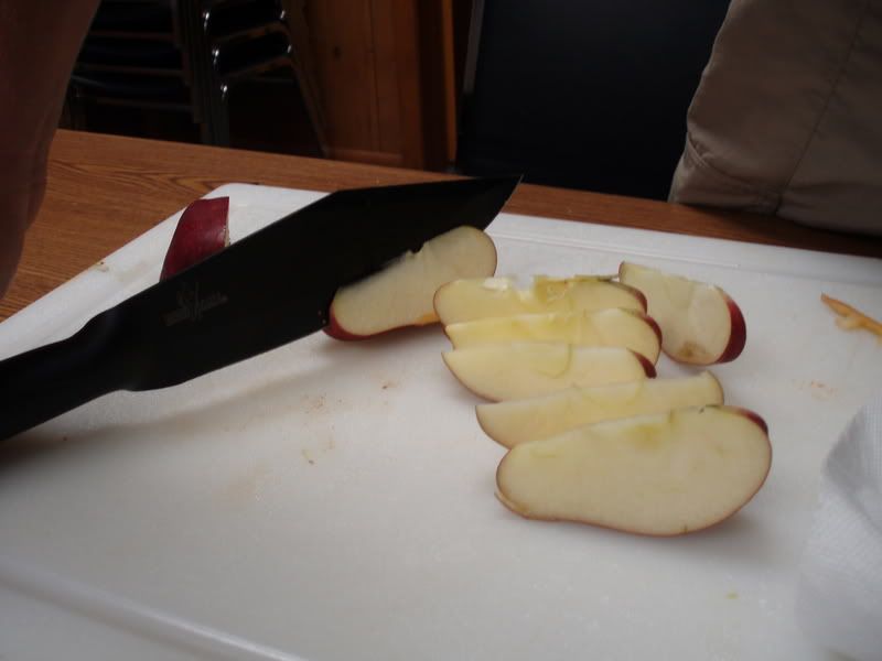

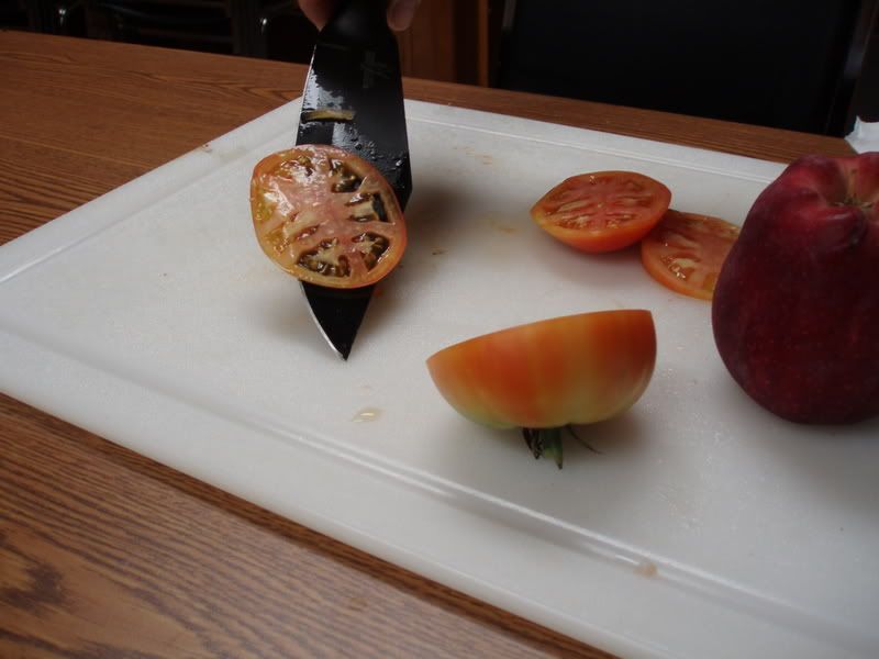

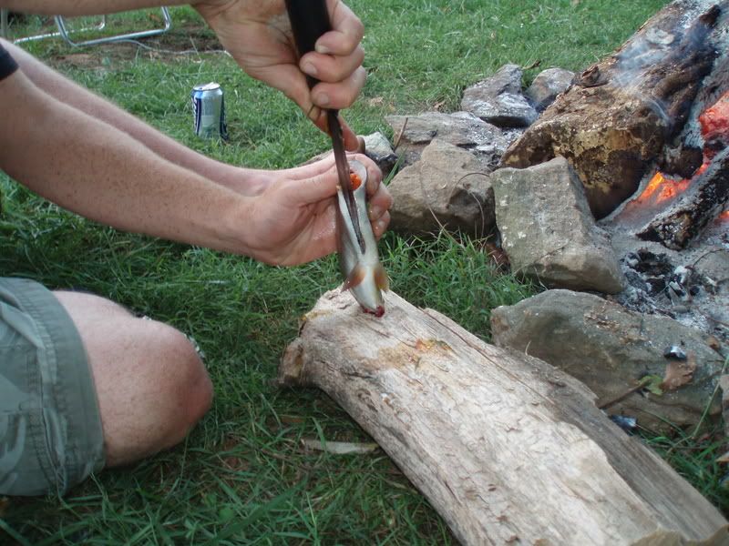

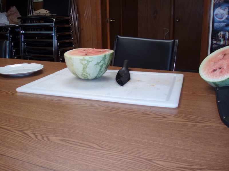

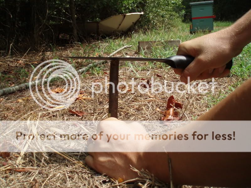

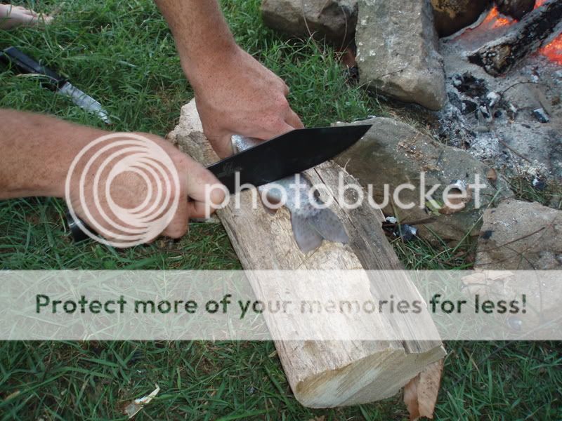

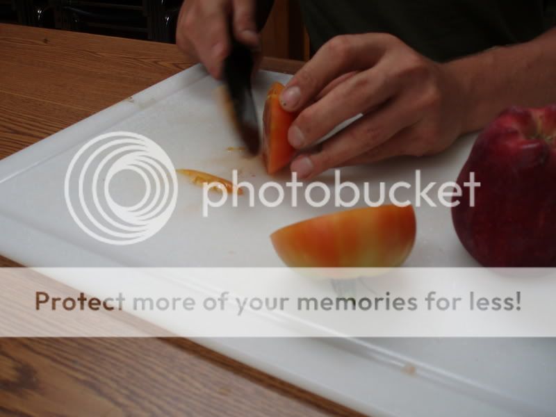

This knife has an appealing thinner blade. The blade is about 2.5 mm, and caused the handle to flex quite a bit when it stuck true in the target. An interesting note is that the blade never needed tamping true due to bending. The thin blade made it easier to choke up close to front. The knife also was not awkward as most 7" knives for use as a fillet knife. A trout was cut and gutted very easily with the knife. The tail of the trout had to be cut off due to an odd lump. In the kitchen, it sliced up apple, tomato, and watermelon quite well. This would also make a wonderful camp/canoe knife. How often do you have a knife big enough to cut watermelon yet small enough to cut a tomato?
As a fillet knife:

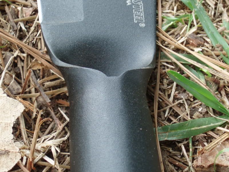

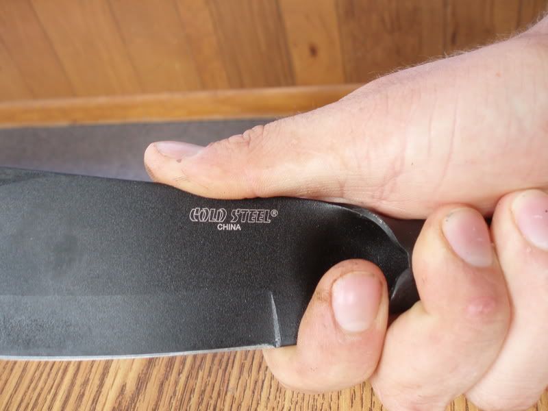

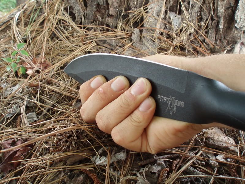

Any other left handers out there with a Bushman of either style? I have one and I really want to like it but it has one flaw imo.
When holding it in my left hand and and choked up a little, the hollow area of the folded handle falls right at the base of my index finger. This takes away an important area of support for my hand and makes it very hard to grip with a high level of force. Right handed, not a problem. Has anyone else noticed this or is it just my own little quirk? Like I said, I really want to like these things but making tinder curlies or similar is just problematic.
