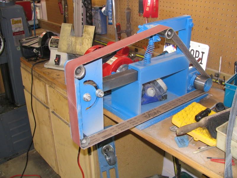

Sturdy looking grinder! Looks great. Mine is well on the way! Have a 3/4 HP motor on it for now that I had on hand. Turned the drive wheel today. Have tracking adjustment done. Just need the tracking wheel and contact wheel, platen etc.
