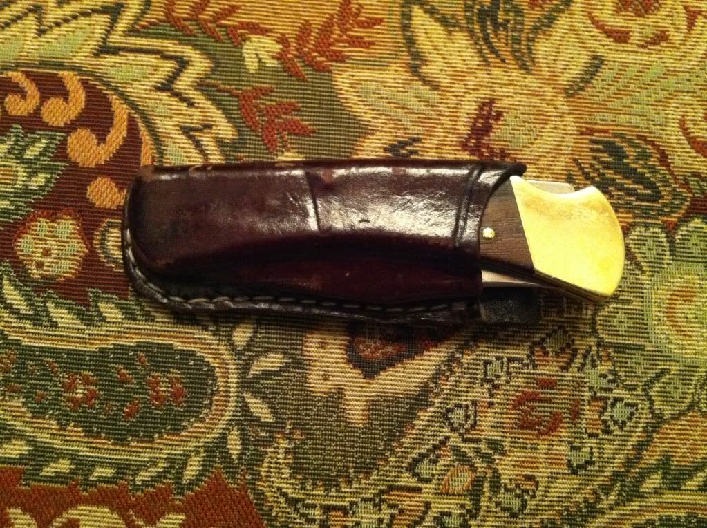

What kind of knife is it? You could always make your own sheath. There are tutorials all over YouTube showing you how. I've made a few from leftover latigo leather from my razor strop for my old buck folders. And wet forming veg tan leather is fun too. Here is the one I made for my 2dot buck 110. It isn't as bulky as the factory sheath and there is no flap to get in the way. A good wet formed sheath lets the knife lock in kind of like kydex.
