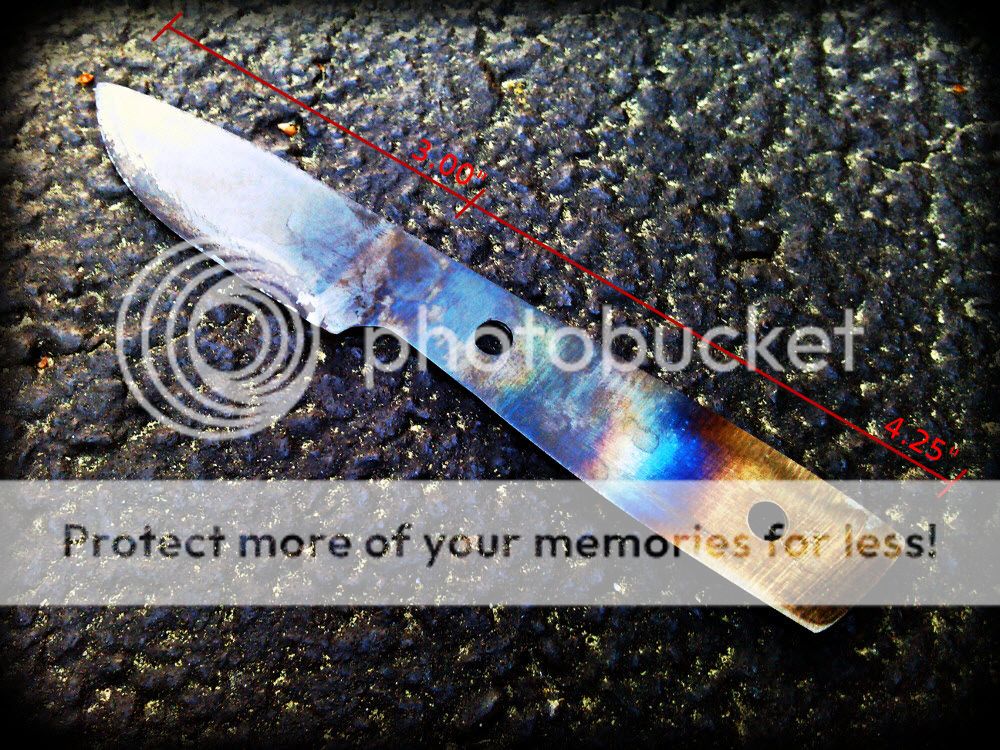

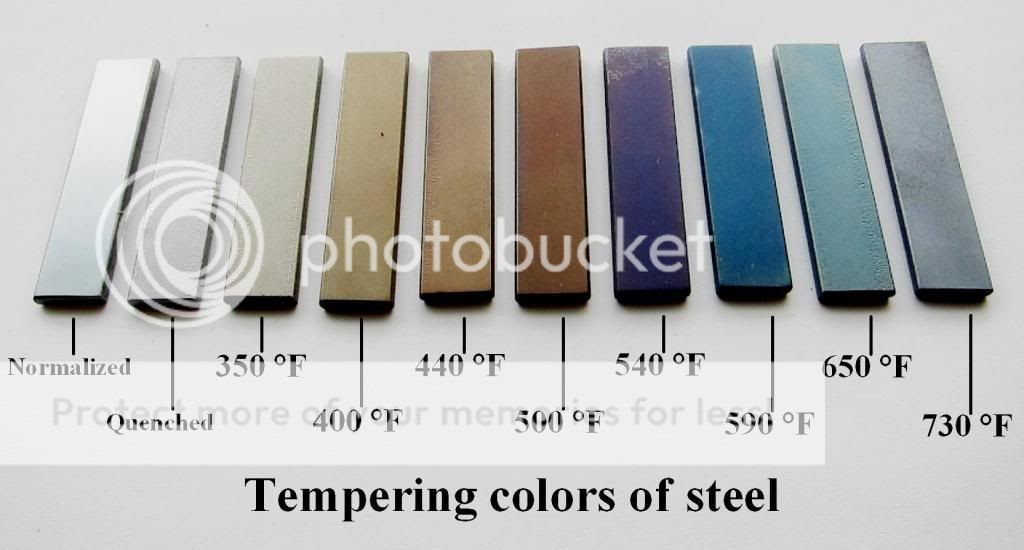

It looks like heat was applied to the blade to create that effect.
Yep, you'll have better luck doing that with a blowtorch than with chemicals. And if it's not a carry knife, you won't have to worry about damaging the temper of the metal.
ya that looks like a heat induced patina. if you carefully use a blowtorch to heat up the steel you can get coloration similar to that. it will totally scew up the heat treat on the blade but its just a thought. also if you screw it up you can always sand or blade down and try again until it turns out right.
