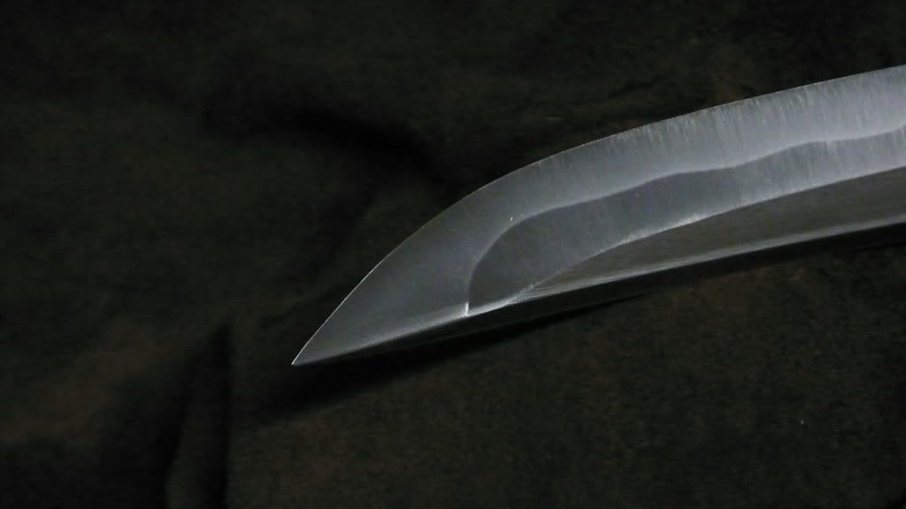

To answer the question can modern makers useing none traditional methods make better performing blades ? in my opinion yes they can makers such as Howard Clark with his L 6 blades and the late great Phill Hartsfield with his special heat treated A 2 blades are definately IMHO better performers than blades of old. But they are also in the 6000.00 to 10000.00 dollar range which is in sword language not very expensive.
I have cut with Phill's blades for many years and my first one has never been sharpened and will still shave and cuts like a demon

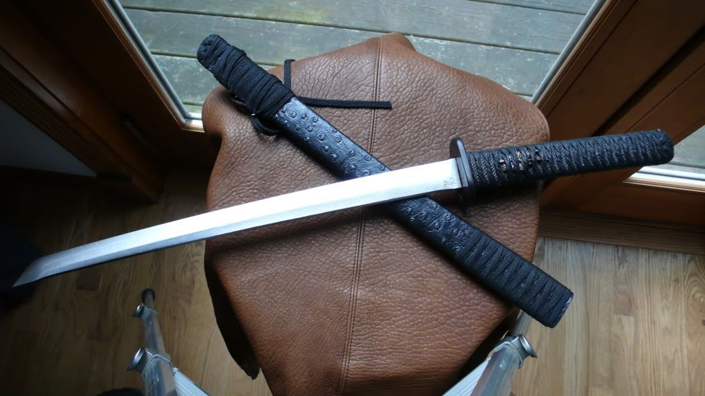

Help me expand Steve. I took your advice and looked up O-tanto , Blade length 12"-15". Shorter than the bussekin. Ko-katana 24"-26" blade length. Longer than the bussekin. My reference source "wikipedia" and "sword forums international". If we go by your suggestion,and according to these reference sources. The o-tanto is too short. The Ko-katana too long to compare to the busse blades. Are these sources I used incorrect?
Yes and no...there are no super firm length mandates in Japanese sword nomenclature, more like generalizations. The exception to this would be the wakizashi's MAXIMUM length, as almost anyone in the middle class that could afford to do so in feudal Japan could wear a wakizashi, but only Samurai could wear katana.
The vast majority of wakizashi that I have seen from Japan have blade lengths from 14"-16" and are quite thin compared to Katana or even o-tanto blades.
If you took a wakizashi length blade of 19", and fit it with a handle that was 10.5" long, with a katana tsuba and other mounts, it would no longer be a wakizashi, but would be in fact, ko-katana. That would be the closest matchup in dimensions to your Busse AK-47.

Folding was only done to make the billet more consistent, i.e., that all 'impurities" were worked out, much the same as a potter kneads the clay, to work out air bubbles and such. Modern steels do not need this process as the proceedures for smelting iron and adding carbon and other alloying materials is far more consistent than any traditional manufacturer could accomplish. So, the modern steels wouldn't gain anything from folding as all that work is accomplished at the foundary. When the modern swordsmith gets his steel from the foundary he can be assured that it meets all the appropriate ASTM standards for composition of the material. The tradtional manufacturer was working with only intuition, experience and tradition.
The following quote from wiki is consistent with other references I've come across regarding the smelting of the steel from which the Katanas and such would be forged.
The process described in the first bolded section above is what the modern swordsmith does not need to do since modern steels have all been smelted and forged to fairly tight specifications. This process would have been taken on by the traditional swordsmith with varying degrees of consistency from smith to smith and I would say even from year to year with the same smith. Either way there was some element of imprecision which would make "tradtional" steels of lower quality than modern steels.
In the second bolded section, again the modern swordsmith does not need to fold his steel as the material would arrive at his shop already forged to an exacting ASTM standard which garauntees minimal, if any impurities and consistent distribution of carbon and other alloying minerals in very specific percentages. And this is all done by machines which do not experience fatigue like the swordsmith.
A traditional smith on the other hand, may or may not be on top of his game on a given day and the quality of the welds in his folding may not be up to snuff. I'm sure a master smith could produce high quality highly consistent steel repeatedly, but nothing like today.

Hold and cut with for example a Hartsfied Wak compared with an AK one makes the air bleed the other does a good job no a great job of what it was ment to do.
This is a Hartsfield Wak
Phill's interputation of what the Japanese Sword would have evolved to exemplifies a modern non traditional Japanese styled sword
Here is a Tanto with a blade that might be close to size of some of the Bussekin swords
Phill used A 2 and is one of the only people that I have seen put a heat treat that left a Hamon on A 2. By the way my original AK was A 2
