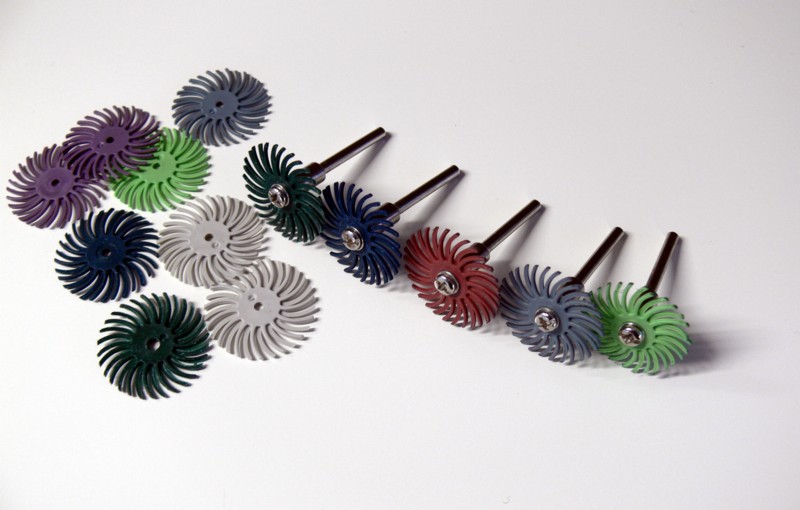

http://knifegrinders.com.au/05Equipment.htm lists "Radial bristle disks" for serration sharpening.
