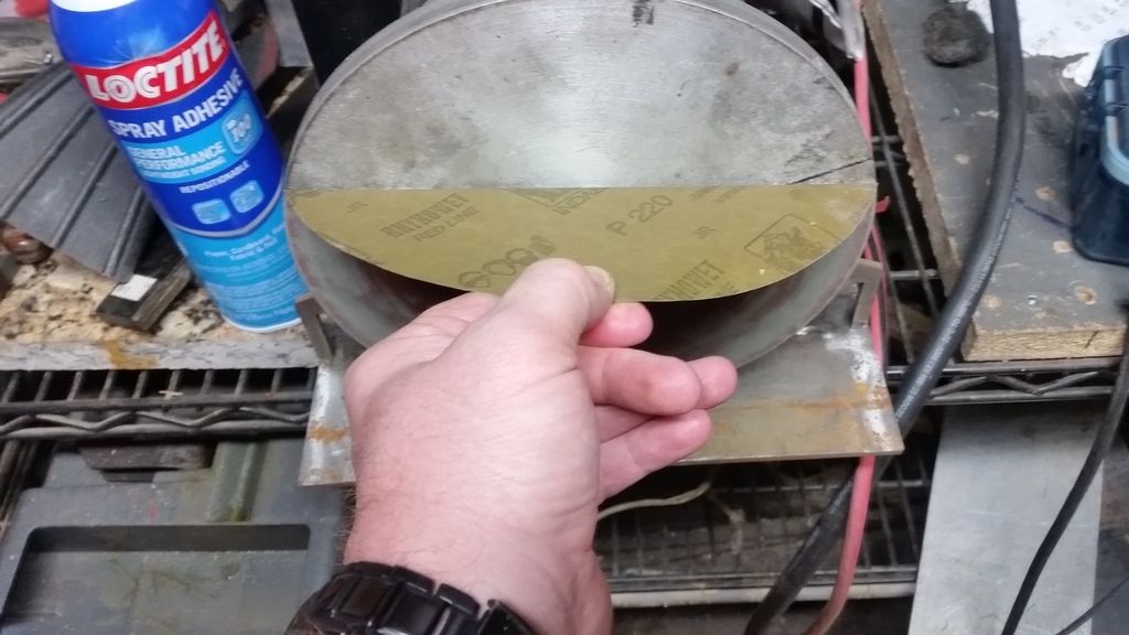

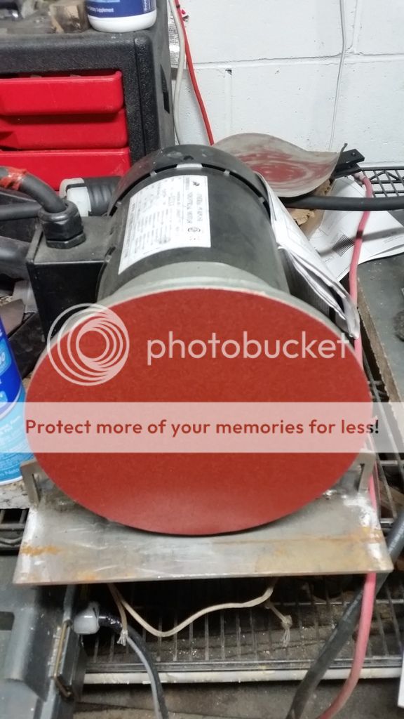

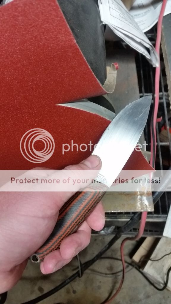

I actually had to do this tonight so I took a couple pics.
Viola!
Thanks Nick Wheeler!
Save the scraps too.

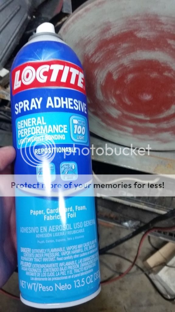

Edited to add. I looked for the feathering disc adhesive locally and couldn't find it. I was going to order it on the internet, but this stuff did the job. If the build-up gets too thick, I take it off with some acetone.

I've been happy with 3M Repositionable 75 Spray Adhesive.
As for needing to clean it off with acetone, while I'm sure I'll have to clean the disk off eventually the adhesive mostly comes off with the paper leaving the disk pretty clean.

I've learned so much from watching Wheeler's vids, is it nitpicky to ask whether there's any advantage to trimming the sandpaper from the top rather than from beneath? I use a sharp box cutter and prefer to cut paper rather than rocks, but always wonder if I'm missing something, since Nick doesn't seem to do anything without considering what's best.
