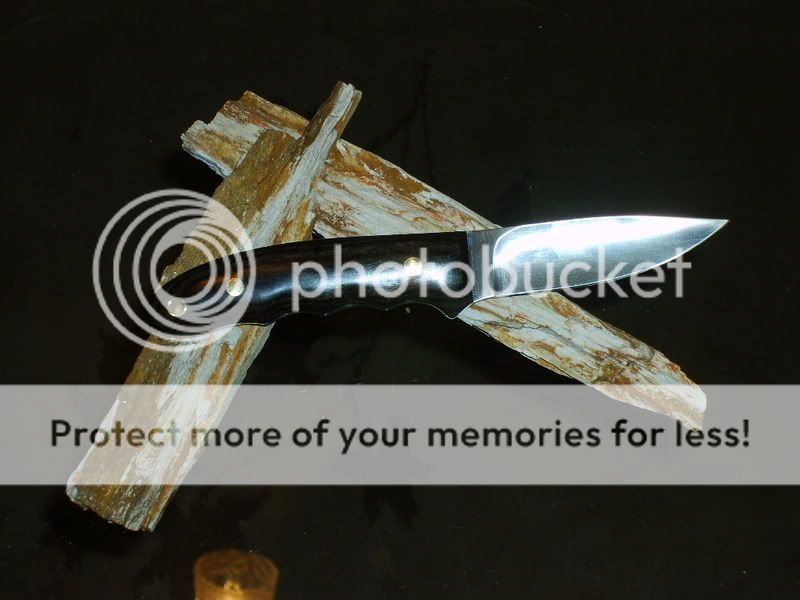

I only paid $60 and as I stated before, its just a semi custom with a mail order blade of which was manufactured in Seki Japan (wherever that is). I haven't used it much or started any testing. But it is a 3.5inch drop point hunting/skinning knife. It will be used ocassionally for said camping/hunting duties, as I have other more specific knifes for personal carry or heavy use.
I agree with Cosmic, that some low quality Chinese imports have burned alot of people on this steel as they never seem to be heat treated well enough. But my unscientific study of the blade I have says its not some soft ass Chinese crap. And i do believe the knife maker on its somewhat decent quality, as he never said "it's the best" only that he wanted to try his hand at perfecting his craft at a decent price before jumping into more expensive steels.
Sure, it would be nice if every newcomer to the trade could afford s30v, ATS-34 or AUS-8 but most can't.
Here's a pic:
Looks like a very nice edge profile (high grind, very narrow edge), it should cut very well.
-Cliff
Your new knife reminds me of Bob Dozier's designs. Very nice looking. :)
