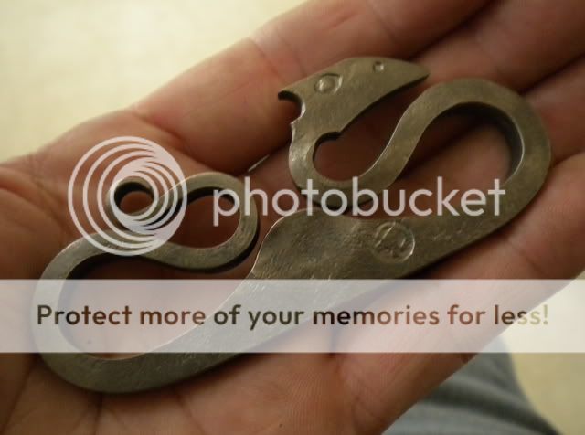

Talfuchre... for steel strikers, you are good to heat with a torch to bright red (not orange) and quench in warmed canola oil or water depending on the steel type.
Here's the coolest looking one I have. I didn't make it, but forgot the guys name who did. It was given to me as a gift a long time ago. Anyway, it sparks great. You can see the straw temper.
I use a length of square 3/8" W-1, give it a couple of bends, a little soak time in the forge, and quench in "Canola Oil"
(just kidding, Tai) quench in Parks 50. I don't temper at all; use it "as quenched". Works great.
