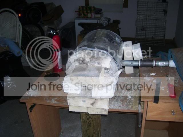

However hot it is, that's how hot my new natural gas forge just got. :D
I got it all built up and dried out, then I poured the coal to her just to see how hot I could go. I was a little dissapointed because after 5-6 minutes I was at a very bright orange heat and it seemed like it stalled. I threw in a bar of O-1 and let it equalize. I tried to pull it out and I ended up leaving half of it in the forge, and another good chunk just fell off the end of the bar just as I got it out of the fire. Then I realized what had happened... the garage door was open and the lights were on. That bright orange was a bright white in a good forging light! The good news is that I don't ever have to buy sparklers again as long as I have this forge around. The bad news is that these new sparklers are pretty expensive. ;)
I'll get some pictures up as soon as I can, but have you guys ever heard of getting this hot with just residential pressure natural gas? It's blown, of course, and my 1/2" orifice size might have something to do with it.
Maximum forging temperatures are 2200-2300 F ,steel melts at about 2700-2800 F. After 2300 F you get rapid oxidation of grain boundaries [burned steel ], then you start to melt grain boundaries then melt the whole thing.
Mete,
Thanks. I don't have a thermocouple for this one yet, so I had no direct measure of the temp. At those temps a thermocouple won't do me much good anyway. I'm thinking of doing some small buttons in the future, so this was more of a proof of concept than anything. The forge is horizontal, so I may have to redo it, but it's at least nice to know I can get in the range using the fuel I have plenty of. I expect it should get hot enough given enough time. The only problem then is the refractory. I'm using perlite and furnace cement, and it vitrifies to a nice coating. Off hand, does anyone know of a castable that will take 3000°?

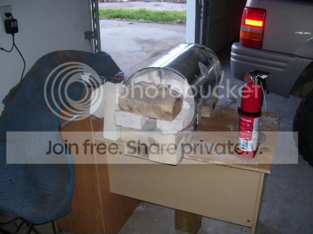

Here are some pics and videos of the forge. Yes, that is galvanized flashing for the body. Yes, I know about metal fume fever. I just burned off and trimmed the parts that would get hot. The spots you see were hot spots that have been repaired. Now it's about 130-140 degrees on the surface when it's running. No need to fear galvanized...just respect it. After I'm done trimming I will shoot the whole thing with grill paint.

I love the fire extinguisher right handy like that. I will be getting one soon too. kellyw
I keep a 25# extinguisher by my shop door. I recommend one for everyone that cuts, burns, welds or makes sparks. This might be the best piece of equipment you can own. I have several small ones in the house. I keep a quality garden hose with a sprayer laid out handy also> you hear of guys burning their shops down. It can start in a instandt. Give yourself a chance. JIM
Is that forge lined with any refractory, or is it just a kaowool blanket as a lining?
Stacy
Stacy
Stacy,
There is no kaowool actually in the forge. What you are seeing is bits and pieces I use to seal it up where the bricks on the front let some flame leak by. The insulation in the forge is 2600° IFBs and 60/30/10 perlite/thin set mortar/furnace cement to fill the gaps and layer over the bricks on the inside.
