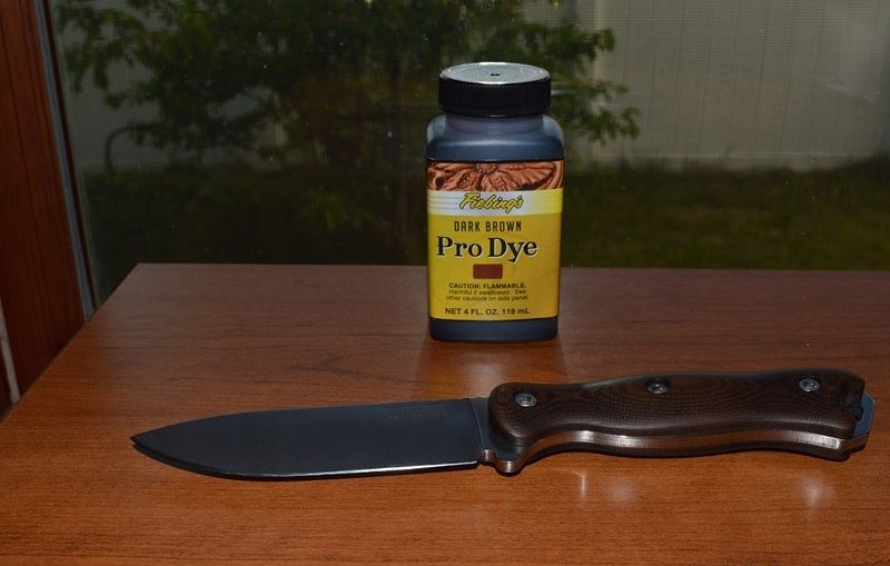

I use Fiebings Proffesional Oil Dye for leather. I like dark brown but you can do any color you want I assume. I have done brown and black. Black hides most of the "grain"
I use a cotton rag like an old T shirt. Apply heavily leaving a bunch on it. Don't wipe it off. Let it sit for 24 to 48 hours. Then wipe it clean and re apply as many times as you want, repeating more for a darker finish. Look at the pictures below for examples.

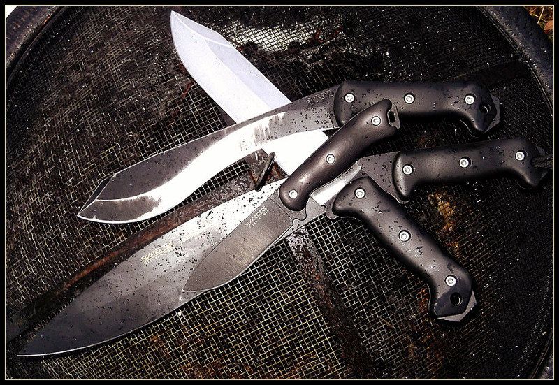

The BK16 in the picture below has Micarta I dyed with Fiebings Proffesional Oil Dye in Black.

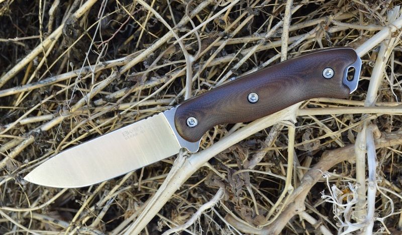

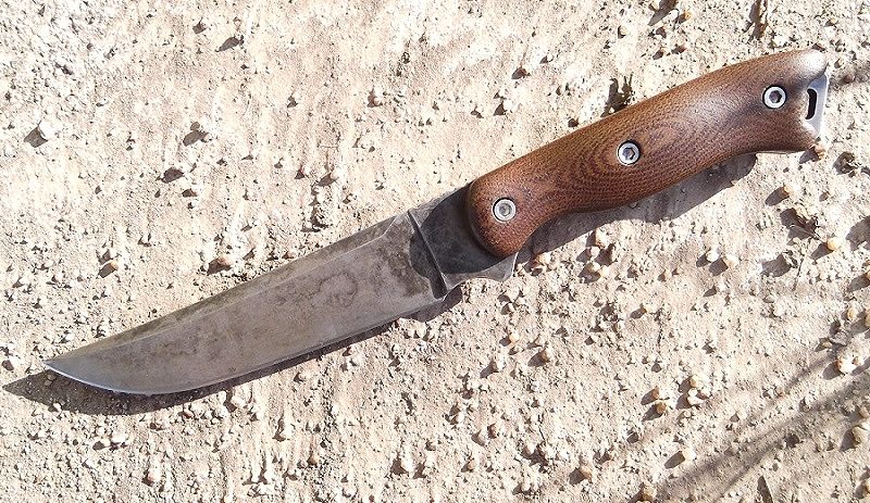

The BK15 below has a lighter dye job but i still used the same dark brown dye I always use. I heavily applied the dye, let sit for 24 hours then wiped clean. I did that 3 times total 3 nights in a row. Then I let it dry for 3 days then waxed.
In the sun.
In the shade.

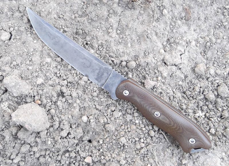

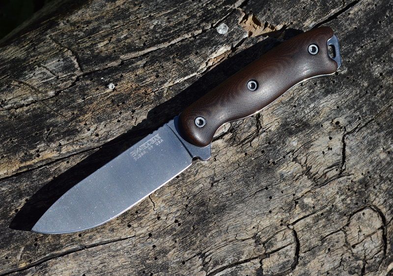

Below is my most recent one. I wanted them very dark.
This time I coated them with dye and let them sit 48 hours. Wiped it clean and did it again for a total of 4 times. Every 48 hours for 8 days. Dry 3 days and wax.
Sun.
Shade
