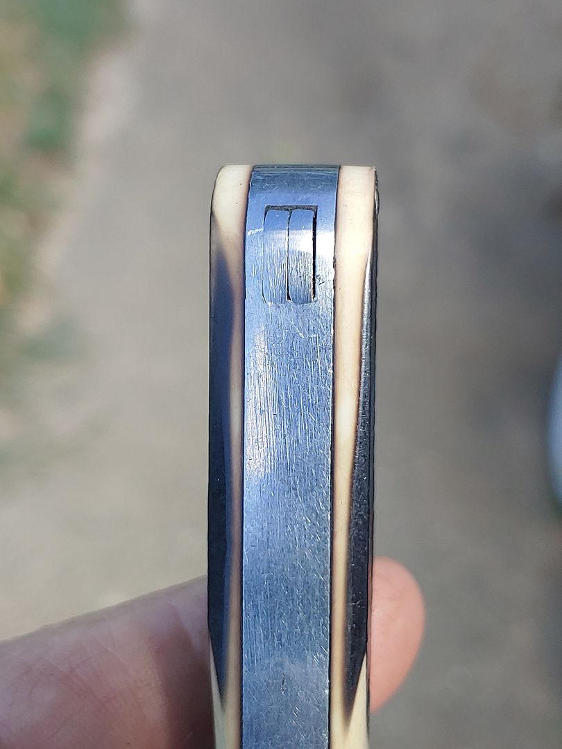

Pic from the net:

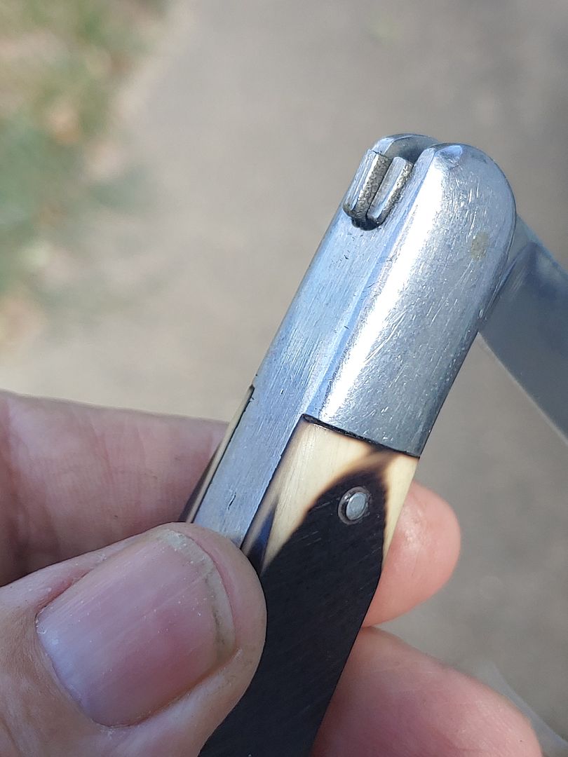

On the Queen, the spring is inserted into its place from the front (blade channel) side, then the blade is inserted, compressed and then pinned in place, holding the spring in. On the Rough Ryder, I don't know as I've never handled one, but usually they are simply pinned together with brass pins, sanded flush and polished to match.

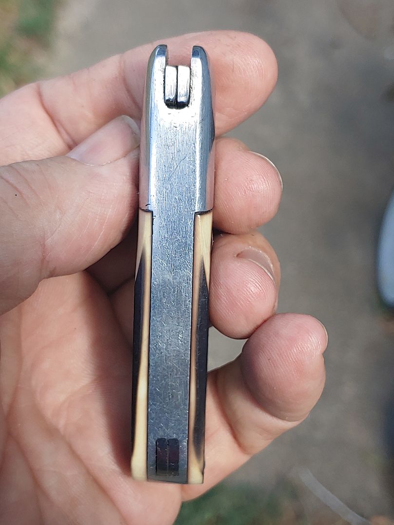

Edit to add: forgot to include the picture of where the spring hooks into its pocket at the butt.
This is the one I was thinking of.
I looked up the patent number once, but I've lost the knack.
Ah, I see. Never seen those before, very interesting, thanks!
Thanks! Now I see, same inserted spring technology as in Douk-Douk.
