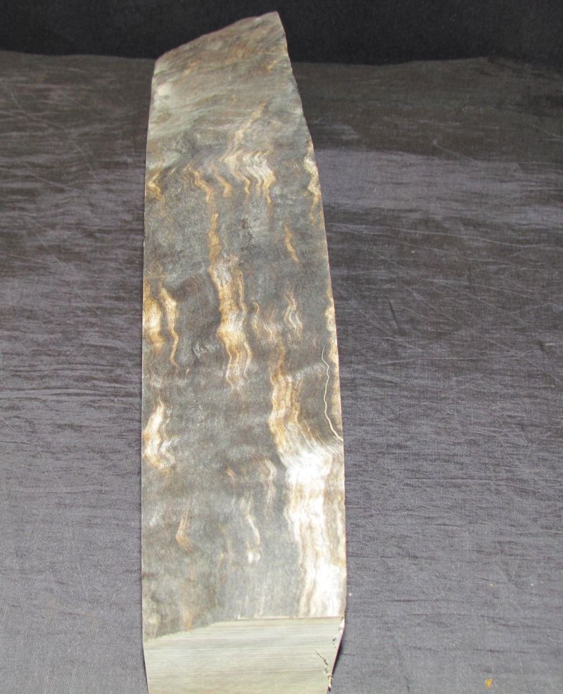

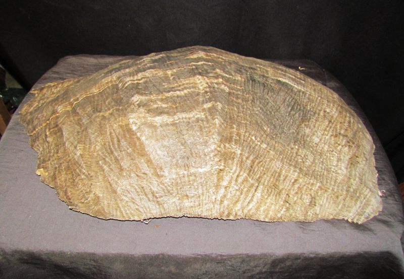

Yesterday I was walking from my office to my cutting area.
I glanced over and noticed this piece of wood that was being used as a piece of landscape decoration.
Not sure why I never noticed it before. It has been right outside my door for at least a year.

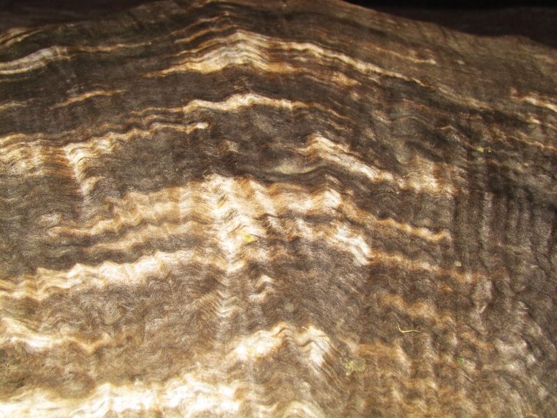

When you look closer you see a ridged surface. That is what you see on the exterior of a piece of wood that will have curly figure.
This piece also has a zig zag grain pattern which is an indicator that there will be good figure on all surfaces.

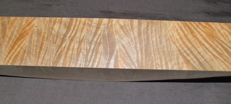

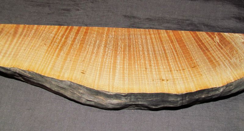

Here I cut a strip trying to follow the grain as closely as possible.
The cut surface that is at a right angle to the exterior surface of the wood is the quarter sawn surface.
That is what shows the curly figure best as well as the small flecks in the wood.
The cut surface that is parallel to the exterior surface of the wood is the flat sawn surface.
Normally that surface does not show as dramatic figure. But the zig zag grain caused the flat sawn surface to have good figure as well.
