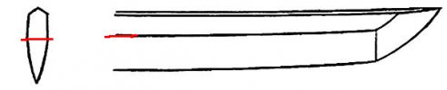

my rough rule is looking how thick the roll/edge bevel is for either one.
This is one of the main differences between Japanese and western style blades.

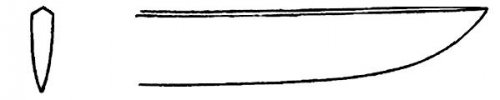

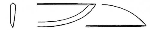

Most Western blades have this roll/edge bevel or whatever you want to call it. Japanese blades do not (with one exception). They are forged with one bevel from either the mune to the edge(Hira-zukuri) or from the shinogi(highlighted in red below) to the edge. The one exception is "Katakiriba"(bottom photo) which is shaped with a beveled edge on one side, such as seen in Japanese kitchen knives.
Here are a few examples of the edge geometry of the Japanese sword.
