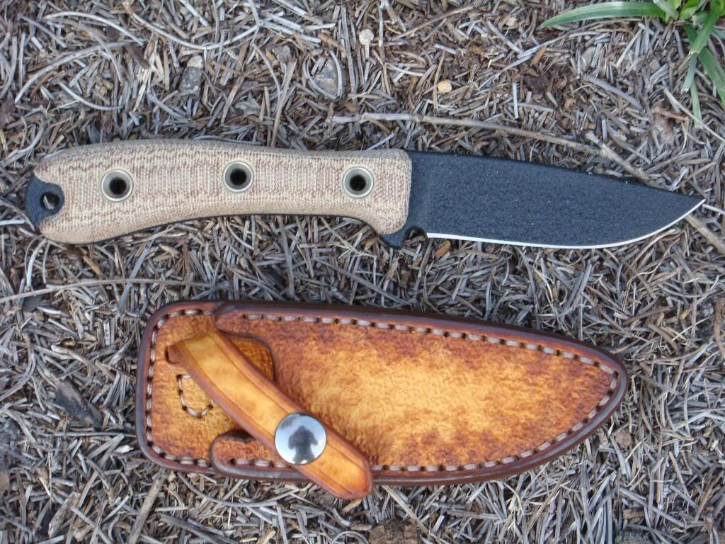

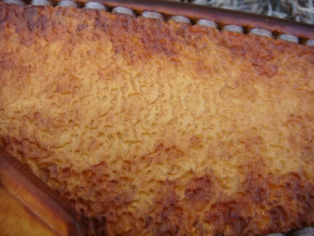

Okee dokee, first off dont use a sponge. It will make an odd patterned effect instead of the soft transitions you want in the pic provided. What you want is a softer/finer tool like sheep skin or better yet a wool dauber. Dont work wet, again that will cause hard edges because of the flooding of the dye in one place making it very dark in only one place with noticeable hard edging.
Daubing is the key here, its a dry brush technique from water color painting. An over wet dauber will let loose a lot of color all at once, a semi dry dauber will let loose a little color at a time. This is what you want when you are looking for a smooth transition between colors. It takes longer to do, but the results are dramatic.
Start light, saddle tan in a solid base or dabbed around in at least 80% of the area. Next you might want to use a bit of Medium Brown to fill in. This will give you a nice light overall coloring. If you want a dramatic effect use some dark brown dabbed in for a stormy effect. You can use different shades and colors to showcase a color in the handle of the knife if desired. That is the lightning bolt effect you see in some of my pieces.
More to come as I am tired, but I leave you with one suggestion, practice practice practice. I colored many square feet of leather before I ever mottled a sheath. And have since mottled hundreds.
