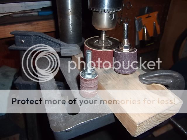

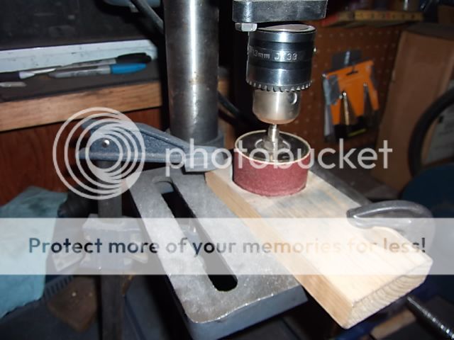

Also, here are a couple of pics of my crude drill press sanding "set up" ,, you can raise and lower the table to use up different sections of the sanding sleeves but this is just to give you an idea of what you "could" do :D . I just drilled out a hole with a piece of wood I had using a hole saw and used the smaller drum to make the hole big enough to fit that big 2" drum (The soft wood also helps keep from scratching the blade like the rough metal table would do) Also, the thicker (taller) the material you use, the more use of the entire length of the sleeve you'll be able to get by adjusting the table height, unless the hole in the middle of your table is large enough to allow the drum to pass through it, then the thickness doesn't really matter.
Hope that helps some :)
