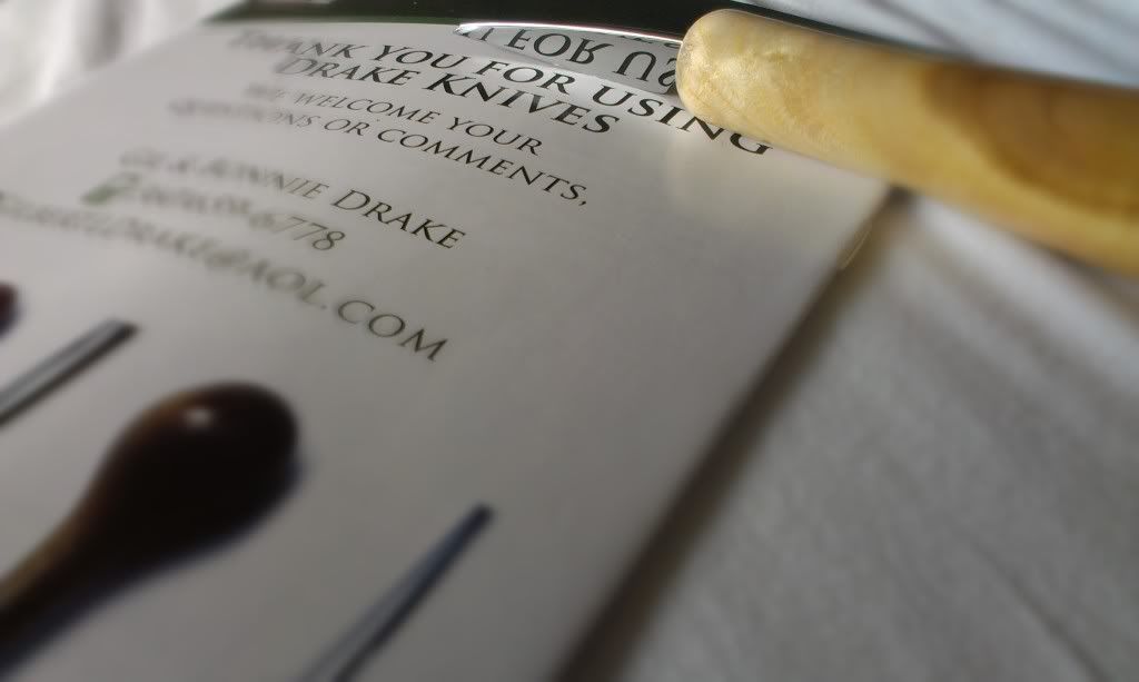

Hey guys. Just got a handmade carving knife. The edge has no bevel per se. It looks like a convex zero grind, and the blade is 1 3/4" long.
Here's a pic
These knives need to be razor sharp and this one certainly is! I want to keep it that way, but I'm not sure how without putting a primary bevel on it.

If it's a convex zero grind, these are really, really easy. I have a couple Opinels that I maintain in exactly the same condition. Just 'strop it' (edge-trailing) by laying the lower portion of the convex flush to some wet/dry sandpaper on a fairly firm but forgiving backing (like thin leather on a hard backing, or over a few sheets of stacked paper on a hard backing). To maintain it at/near the high polish shown, use high grit (1000/2000+), and then strop the blade on leather w/compound in the same manner, with the blade flush. If it needs a little more work, start lower in grit at anything in the 400-800 range, then follow with the higher grits and stropping, in the same manner. Laying the lower portion of the convexed blade flush to the sharpening/stropping media makes angle control as simple as can be. Just make sure the edge itself is making contact (lightly), and minimize pressure exerted, to prevent the sandpaper or strop from rolling over the apex.
As you get familiar with this technique, you might work on doing it on increasingly firmer backing, like thinner leather, harder wood, or a sheet or two of stacked paper over glass (this is how I like to do it), which will help keep the edge as crisp as possible.

I was looking at the web page for these knives, and the edges do look convex, though not as much for the blade as a whole (like Opinel). I'd still use sandpaper over a firm backing (the firmer the better), in a stropping fashion to maintain them. The convex is closer to the edge itself, so it's a bit rounder. The blade as a whole seems to be flat stock, maybe with a little taper towards the edge. Keeping the backing under the sandpaper as firm as possible will help to minimize any excessive rounding beyond that. If it were mine, I'd probably be using the sandpaper directly over glass or hardwood.

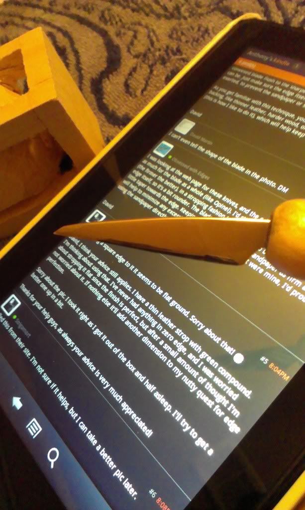

After holding a square edge to it it seems to be flat ground with slight convexing at the edge. Sorry about that! :o
David, I think your advice still applies. I have a thin leather strop with green compound. I'm thinking about using that. I've never had anything in zero edge, and I was worried about stropping it flat since the finish is perfect, but after a small amount of thought I'm not worried about it. If nothing else it'll add another dimension to my nutty quest for edge perfection.
Sorry about the pic. I took it right as I got it out of the box and half asleep. I'll try to get a better one up in a bit.

Look like it has a full-convex grind. You may try using dry marker to put a few big X on the blade face (spine to edge), then scrape it flat on a piece of white paper, the worn mark might clue in what its actual grind profile.
David's suggestions are very good for wood working tools in general. But sound like you don't want to scratch the mirror look. So, it's good idea to strop using the finest compound on hardest backing. Could even try strop using Cr0 (0.5um) on a packing/scott tape, which is tape onto a glass surface. Always approach at the lowest angle possible (zero/lay-flat in this case).
i overlooked where you checked the blade with a straight edge :D. i sharpened about 700 woodcarving knives a while back for a member and he had me flat grind them all to get rid of the shoulder from where they were hollow ground instead of flat ground. i would put some tape just above the edge to protect the biggest part of the blade and then lightly strop it.
Yeah it gives the appearance of being convex because there is a very slight convex at the edge and the top is rounded.

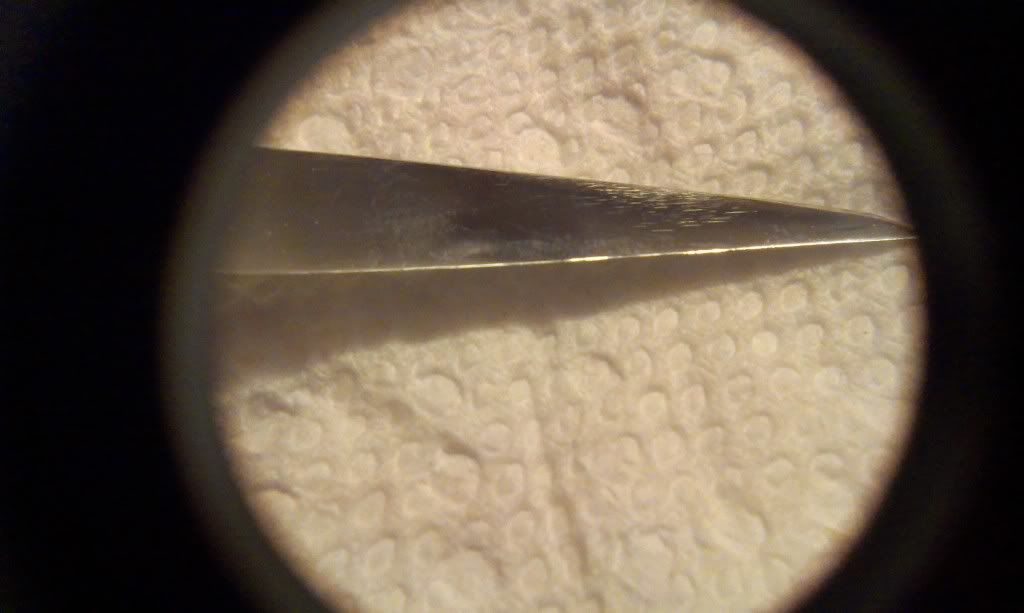

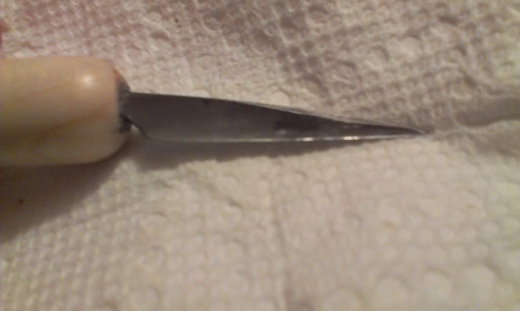

I pulled out my cheap loupes. I'm still struggling to see what is actually going on here. Now it's looking like the edge might be getting waves in it and not rolling. I believe that would be down to a soft ht in any case.
I tried to take pics, but it's very hard with my phone. First is just phone, second is through the 10x loupe.
It's easier to see in rl, but I did my best with these. :o
