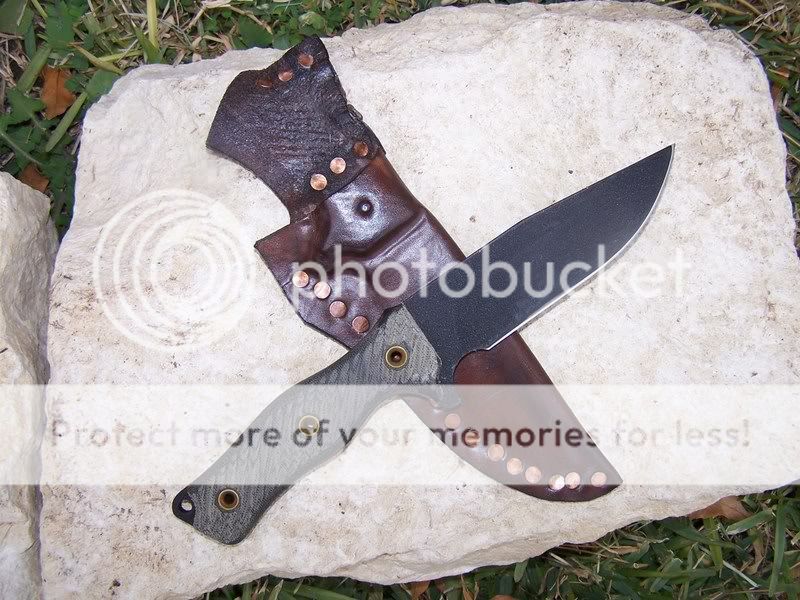

I can attest to the benefits of dipping your sheath in melted bee's wax. It leaves the leather hard like Kydex only much prettier. Just get the wax hot to about 170 degrees and make sure your sheath leather is COMPLETELY dry before dipping. I made my first sheath last weekend and aside from the rivets looking rough, it works great and looks like something a mountain man would carry.
Do a Google search on "How to make a knife sheath" for more info. MAking a small pocket shouldn't require too much additional labor. Just attach it before the final sew-up and wet mold it to carry whatever it is you want the pouch for.

Btw, very nice sheath Maquahuitl -- very rustic!
