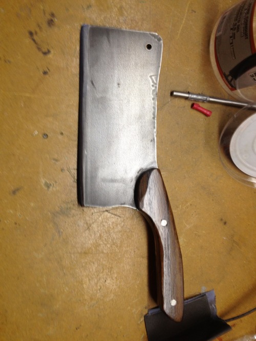

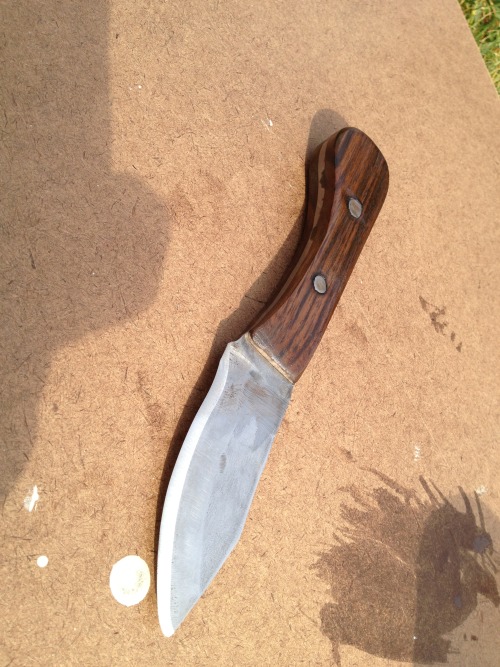

I've been making fixed blades for a while, and while I'm definitely getting better, I don't see my work looking as... finished... as I'd like. I have a couple specific questions, but any general help to give me that edge (pun intended :D).
First of all, how do you get such an even grind line? Usually I use my Work sharp (not meant for grinding, I know, but it kind of works) but it's hard to get a good tip on a knife with it.
Second, is there a kind of treatment or coating I can do to the steel? I use gun blueing sometimes but I don't like how it looks so much and it takes far too many coats to turn the blade darker.
Can't think of any more specific questions right now, but any help would be greatly appreciated.

Pictures added. I'll look into a jig, maybe. I know that one problem is that I'm not sanding down each blank enough, because I left some deep grind marks from where my cutting wheel skipped over the metal...

I'm looking at your pics now. The first knife looks pretty good actually except for the squarish handles. I'd round them more. I don't mind a dull blade like that, but I understand most buyers would want a brighter finish. Spend more time grinding or hand sanding until there are no more scratches in it. Be patient, don't get in a hurry. I'm very familiar with wanting to get a knife done so you can see what it's going to look like. But take any amount of time to finish it until you're satisfied with it. Tell yourself if it takes two days to hand sand it, then you'll take two days and then another if you have to.
I like the cleaver, although I can understand it wouldn't be for everyone. I see a little inconsistent grinding on the handle at the lower section where it meets the blade. Again, I'd round the handle a little more. As for the steel, you just need to spend more time finishing it out. Either with Gator's, Scotchbrites or hand sanding with higher grits. Make sure you start with lower grits and work your way up. Don't try going from a 120 grit to 400 or something crazy like that. Progress up the grits and don't go higher until the grit you're currently using is as flawless as you want it.

What your knives lack is being finished......... that is the biggest thing that separates an amateur blade from a pro blade.
The handles are squared off blocks of wood attached to the knife.....round them to an even curve so the cross section is oval or egg shape.
Rivets should be crisp and clean.
Any changes in direction or curvature of the surface on the handle need to be done smoothly.
Blades need to be smoothly curved, and edges need to be straight, Yours have dips and swells.
The blade surface needs to be sanded to a perfect plane. There should be no marks, dips, gouges, etc.
Go to 400 grit before HT and have it dead flat. After HT, start again at 220 grit and progress to at least 1000. If you want a satin finish, go back down the grits from 1000 until you like the look.
