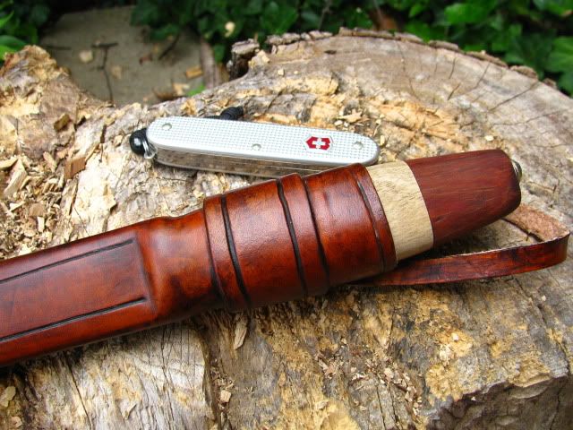

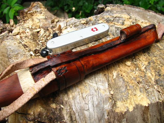

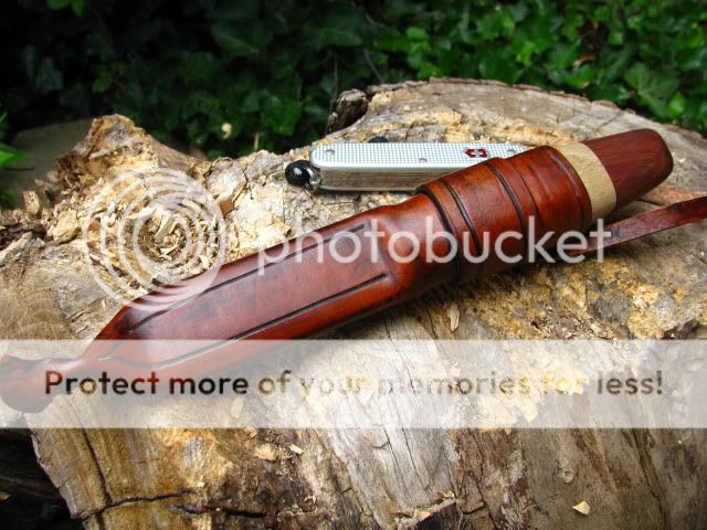

Hi there, I caught the thread from a friend and have made many Scandi swinger sheaths. I can offer tips on the way I do it. It is not necessarily the only or even the best way to do it but I usually have great success.

Wow, beautiful knives!
What kind of wood did you use on this handle? Really well figured olive? It's gorgeous!

Yeah, any tips you would like to share would be very appreciated.
First off, how do you get that raised line in the bottom part?

There are two ways to get the ridge in the center of the sheath. Firstly, when you make the insert that protects the blade you can mill or file away all excess material leaving an 'integral' ridge. This is the way I usually do it. Then simply round the other side on the grinder and smooth off with sand paper. When you insert it into the leather (or stitch leather around insert, depending on your method) simply wet the leather and use your fingers to bring out the shape by applying pressure on either side.
Second method is simpler. Make your insert, grind it round and smooth with sandpaper. Then make a ridge to match the shape and simply glue it on. The advantage of doing it this way is that you can get creative and make interesting patterns rather than just straight lines.
Here is another tip to make the insert.
Some makers use the two piece method of carving out the inside of two pieces of wood to recieve the blade. This is then rounded and smoothed. I found this too time consuming and also the wood sometimes retained moisture which rusts my carbon steel blades. I learned the following through trial and error though I'm pretty sure I'm not the only one who does it. In South Africa we have something called Supaboard. It's a lot like Masonite. Cut three pieces that will fit the size of the blade. Placing a flat edge against the Guard sketch a left, right and center on each piece. With your center piece take a scroll saw and cut out inside the lines then using a file open it up to the lines. Test fit your blade as if you were inserting it into the sheath. If it touches file a little more until it fit snug. If you oversize save it for a larger knife and make another. The cut out the left/right pieces leaving about 5mm of material on the outside of the profile line. Now place one of the sides onto the center piece aligning the cavity with the profile line. Make sure it is accurate then epoxy glue it on. When cured take to the grinder and grind the profile neat. Then apply the other side and glue, then profile. You should nor have a squared shape of the profile of the insert. To finish simply grind off the corners making the insert smaller. When you are done soak the insert in any wood sealant. The Masonite (supaboard will suck it up like a sponge) leave to harden and you have a water tight insert for your scandi knife.
When I make another I will post pictures of the process.
Hope it wasn't too boring for you.

This would work on most sheaths but because of the insert the leather will tighten as it dries making it difficult to keep its wet formed ridges. This method works great for relief wet forming when putting shapes and images onto the sheath.
Here's another tip when drying a scandi sheath. When all has been stitched together I am never comfortable with the loose fit that the leather provides so I use the following little trick. Wrap your knife in cling wrap (not sure what you call it in the states) about three times. Soak the sheath till its very pliable. Insert the blade into the sheath so that the guard sits snug against the mouth of the insert. Using your thumbs form the leather around the piont of entry of the insert. This gives it that curvy shape. Then do the same with the rest. Use a vice with smooth jaws and clamp up the stitching at the back. This tightens the leather even more. Use a round dowel to shape the back and neaten up all the lines.
Now take the wet sheath with the knife still inside and place it in front of a fan. Not hot blowers, just a normal fan over night. In the morning remove the knife and unwrap it. If you wrapped it properly it will be rust free. The sheath should be very dry but not as hard as if it were baked. Place the knife back in and it should fit with a satisfying click. With the wrap removed the sheath is fractionally larger than the handle so it will have a perfect fit.
You can also oil the knife first to protect from rust if you are a forger like me.
