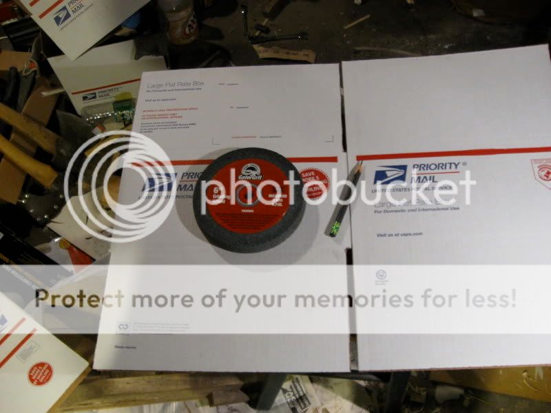

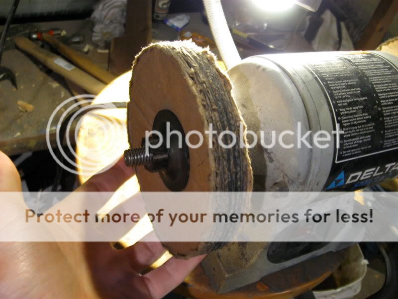

i start with a large priority flat rate shipping box courtesy of the USPS. i trace one of my grinding wheels onto the box a number of times and start cutting with a folding razor knife:

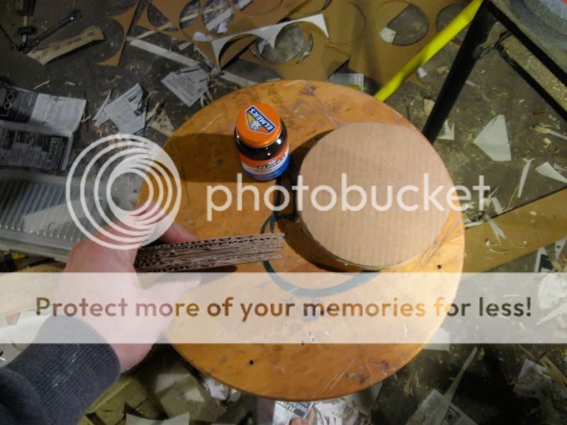

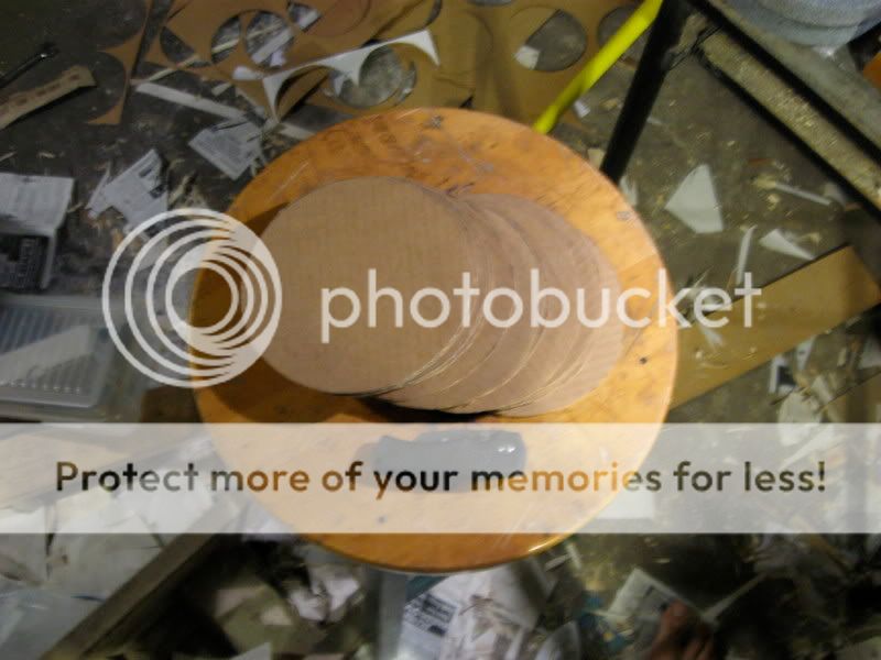

then i break out the rubber cement and start gluing up the discs in two even piles. you can make these as wide or narrow as you like. for general knife stropping i suggest a wider wheel, but i find about 7 layers works well.

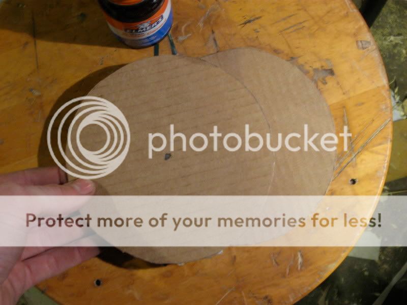

when i glue them up, i alternate the corrugations:

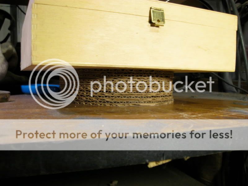

after lining up all the discs as evely as possible, i set them between two flat things with a weight on top to press out air space but to avoid crushing the cardboard (i found about 1# works well)
once they are dried, i use a 1/2" countersink in my power drill to drill out the center of the wheel to snugly fit the shafts on my grinder. i tighten them up with finger tightness, so that the wheel is held firmly but not crushed.

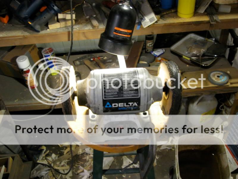

here are a couple photos of my wheels that have had quite a long life of service, and they are holding up great. i just reload them every couple of knives and they work great for me.
hope this helps someone out. any tips or comments are appreciated!

Nice work. It doesn't seem too difficult and I don't think it would be all that dangerous to use either. Considering you are using epoxy to join the layers I can't see where the danger would come in unless you have a weekpoint in a layer that will slip out.
The danger is primarily from rubbing a sharp piece of metal against a rapidly spinning wheel. It's surprisingly pretty easy for the wheel to grab your work right out of your hand and fling it. Obviously, this can cause serious damage to one's body and/or knife.
The potential for this happening exists regardless if the wheel is cardboard or cloth, the latter I have successfully used for knife sharpening. A high level of caution is advised.

just a note; i'm using rubber cement, which is quite different from epoxy. using epoxy would basically make micarta, which can be very dangerous if it shatters. rubber cement like i'm using stays soft and is designed to hold paper and balsa wood, but let go if you need to take something apart. not necessary, i just do it to keep the wheels in one piece when i take them off the grinder.
