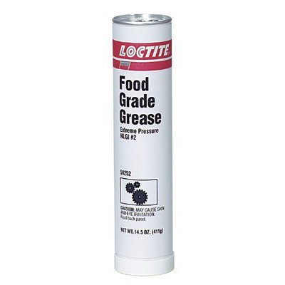

food grade grease?
heat/melt a couple ounces, add grit, stir and allow to cool back down.
if it's too thick, add mineral oil to thin it.

Tormek paste is about $9 for 2 oz. So whatever i end up with, it needs to be cheaper than the Tormek, otherwise its a moot point. The silicone pastes I'm seeing online are all fairly expensive. Food grade grease is a bit cheaper, though I don't know how it would work... maybe it would be good. Miralax would dry out from evaporation, wouldn't it? I'm totally unfamiliar with miralax...
