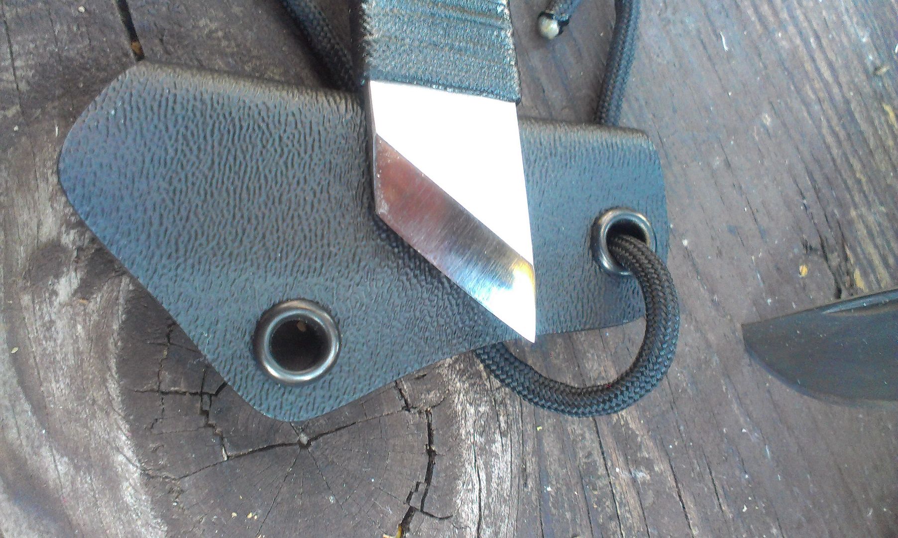

This is a custom dashi that I have. It's been sharpened on both sides and is razor sharp. Not sure what this grind would be considered. A hybrid maybe?
That bevel on the backside is very obtuse, almost just polishing of the steel. It is pretty acute overall though.
I believe that is called a chisel grind done wrong!
Many hardcore chisel fans will tell you that you can't sharpen both sides of a chisel grind, but if you leave a nice acute micro bevel on the "back" side you should be fine. The easiest to sharpen a chisel is to lay it on a stone and rock it until you feel the flat edge (if you want to match the existing bevel). This method is easy, but stands a chance of ruining the finish of a knife, so I would only recommend it for users. Other than that the easiest way is to to know what the edge is through experience. All you need to remember is that stropping or a light pass on your stone (preferably with the knife almost flat, you want to get it close to a 0° edge on the back) will remove the burr.
Unless you get chips or horribly neglect the edge, all you should need is stropping on the back side of the edge to touch it right back to sharp.
Why is it wrong? I think I may have worded it poorly, or made it confusing. The back side is most just polished steel at the edge. It does have a slight convex to it.
I guess it doesn't matter to me. Different is just different when it's exceedingly sharp, which is never "wrong". ;)
It's not "wrong". Japanese blades have many different combinations like 50/50 (V grind), 70/30, etc. Yours looks like about 80/20 to me. The Japanese blades also come in real pure chisel grinds and "almost" chisel grinds (different types of Yanagiba that may or may not have a hollow back side and an optional micro bevel on the back).
All of these blades cut and cut well.

Brian, your right. ;) The only thing I wish is that it were a larger knife! :) On the other hand, it was a gift from a great forum member that was creative (and generous) enough that he had it made alongside a custom knife for his collection as a way to do a giveaway for someone that hadn't had a true custom knife.
It's a fine knife that is going to a friend of mine.
As for the grind, I'd call it 90/10 or maybe even 95/5. Hard to tell in those, admittedly bad, pics.
I'm just teasing you. The pics do make it look like you put a full on bevel on the back side, though. I do enjoy a good chisel grind (only if the grind is a proper left hand grind like it should be!), and find them to be so bloody easy to sharpen. Lay it on your stone, sharpen normally, then just take the back side on nice and acute on your finest stone.
