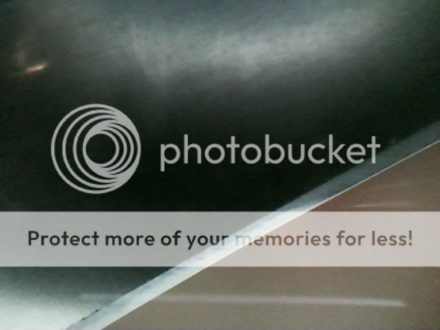

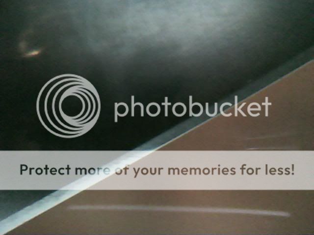

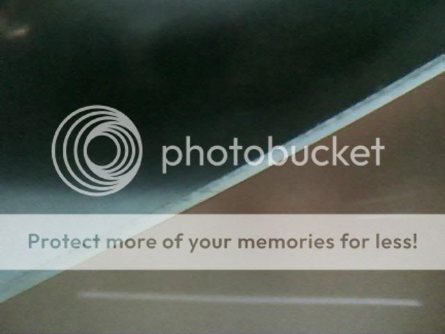

Here are a few pics I managed to take of the edge. Sorry the quality is bad, Im using my laptop webcam with a loupe taped to it :o.

I'm still wondering if this isn't just a tiny microbevel (that's what it looks like in your pics). I think a burr would've been removed after all this, or at least changed. You were able to make multiple (10) slice cuts into the paper. If a significant burr were there, I doubt you would've gotten that far (in my experience, a burr would usually move/flop to one side or the other after the 1st/2nd/3rd cut, after which the slicing performance would noticeably change).
