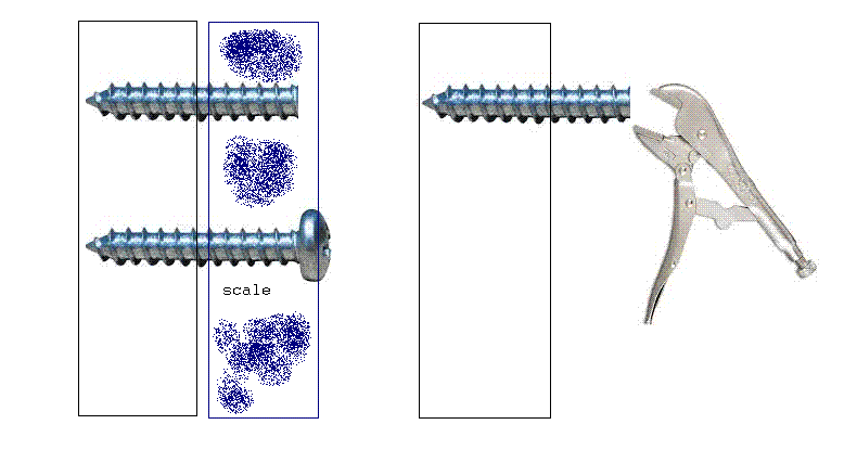

Hey guys, need some help, I ordered a Hinderer MP-1, all the screws were loose out of the box, I went to tighten each one, I know I didnt over tighten, I had some high end productions so I know the drill, but this one screw on the scale just broke off, I dont live in the States so sending it in is not a choice for me, I also never use loctite, is there a way to remove this screw, I already ordered a complete set of scale screws, so my only concern is the Ti scale,

Take the other handle screws out and remove the handle. The handle should come right off if the screw head is gone. Remove the broken screw(it should be sticking up) with vise grip pliers.
The absolute best advice in this thread.
