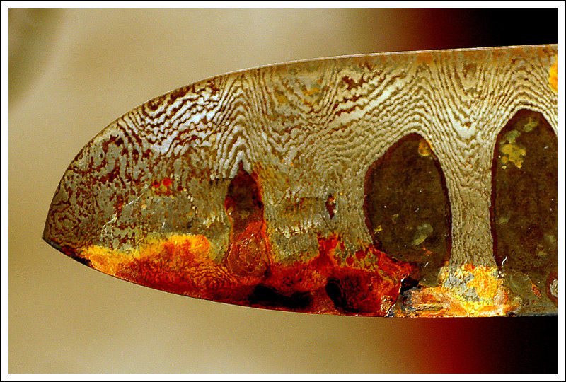

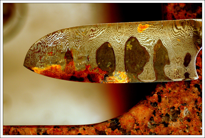

Knife used to dice potatoes, left intentionally unwiped and with water over it for about 24 hours.
Close up. You can see rust in different stages.

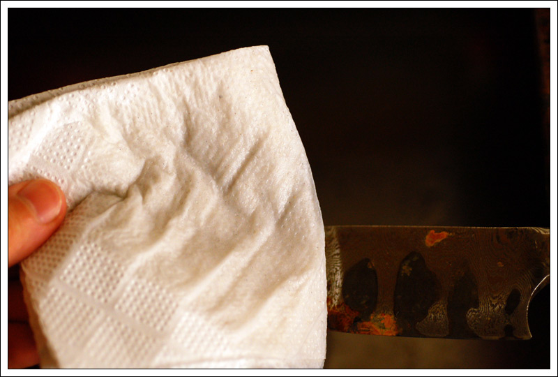

First step. Soaking a paper towel in tap water.

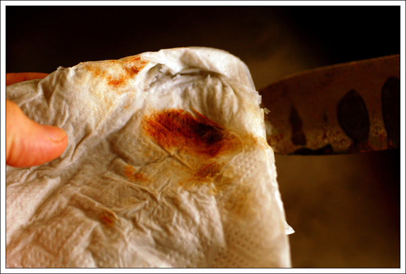

Once you swept the blade with it.
Resulting blade. This will usually take care of ALL the rust on the blade if you just forgot to properly dry the knife or forgot it on the kitchen top a few hours unatended.

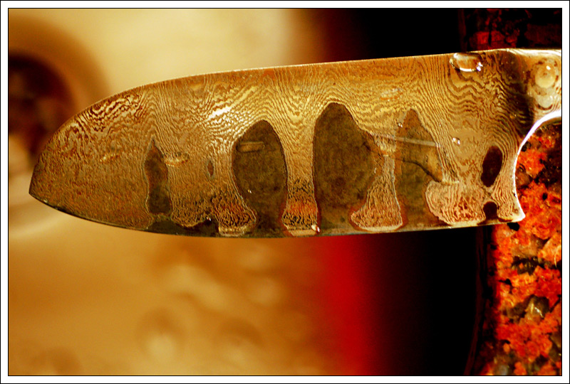

Now dried up.
Close up. No more rust. Damascus still looks nice.
The entire process to clean up the knife took less than 2 minutes, and we get a knife that's as good as new. You don't need any special "knife" knowledge" or dedicated tools, it really is as simple as it looks.
