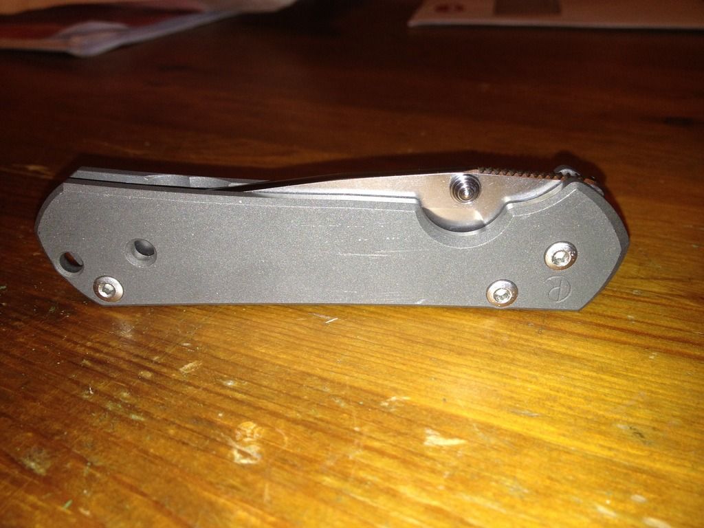

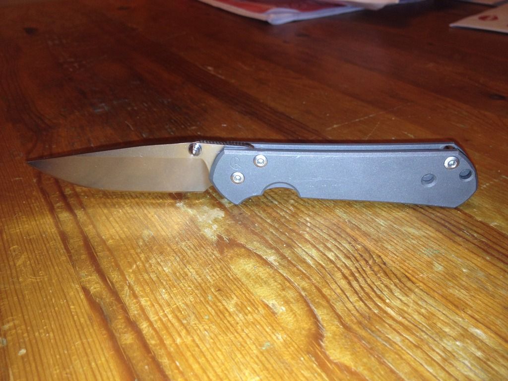

Did my small 21 this morning. Looks awsome now.

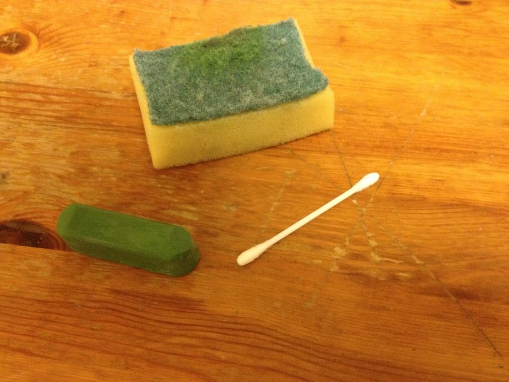

I used a sponge, those with the abrasive pad on one side, rubbed with the green compound you get in brick form and polished away. For the back of the thumb stud I used a Q-tip rubbed with the same stuff. Backspacer was done on a strop. The lanyard pin I didn't bother with and just removed it, never use it anyway..
