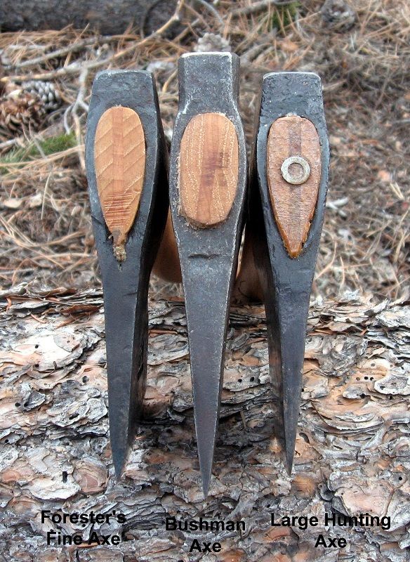

Rest assured that if your axe is ground similar to the one below, I'm about 95% sure it's the blade geometry and not a heat treat problem:
It's a very solid full wedge shape which is great for splitting but if they gave it a conventional edge, it wouldn't be too great for felling or other such tasks as it would be to thick and wouldn't give good penetration. To compensate, they put a very aggressive high grind to keep more of the edge thin. Too thin. This would be fine if they added more pressure onto the belt sander to give it a gradual convex to the edge, but from the looks of it, it's MUCH too gradual a convex (nearly flat) bevel. The end result is that the blade is probably about 25-30 degrees overall at the edge without much metal to back it up.. and that's not going to hold up to heavy chopping. Ideally you probably want 35-40 degrees overall (like the axes to either side of the bushman). You don't have to completely reshape it though.. I'm pretty confident a micro-bevel will do the trick.
Yeah I guess I didn't look at the picture very closely - looks like it rolled about 45 degrees off center so the metal is definitely compromised. I retract my statement on steeling :(
I am obligated to state my opinion here, being a big fan of wedgy axes of all sort--
No, that axe is not profiled for splitting. it doesn't have the hollows of a normal thin "chopping" axe. Both axes in Killa's photo would be easier to turn into "splitting" axes by fattening the edges. It would take a lot more removal to make the middle bushman axe into a splitting axe. the shape of the face 2 and a half or 3 inches up the face doesn't have much to do with the presentation of the first 5MM or so, which is the important area in regards to being suited for a specific task (followed in importance by the subsequent next 5MM). The straight line wedge shape does help when you are chopping green wood though, where biting too deep can sometimes be a concern.
