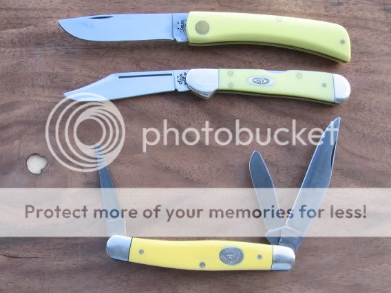

I use hot apple cider vinegar to patinize my carbon steel users. Attached is a picture of a Moore Maker punchblade stockman that has that treatment, so that you know what to expect. It too has 1095 steel blades. It's the one on the bottom and is one of my most frequently used knives.
