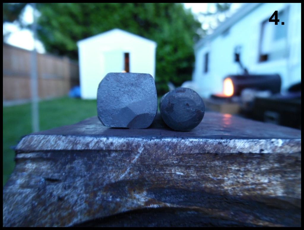

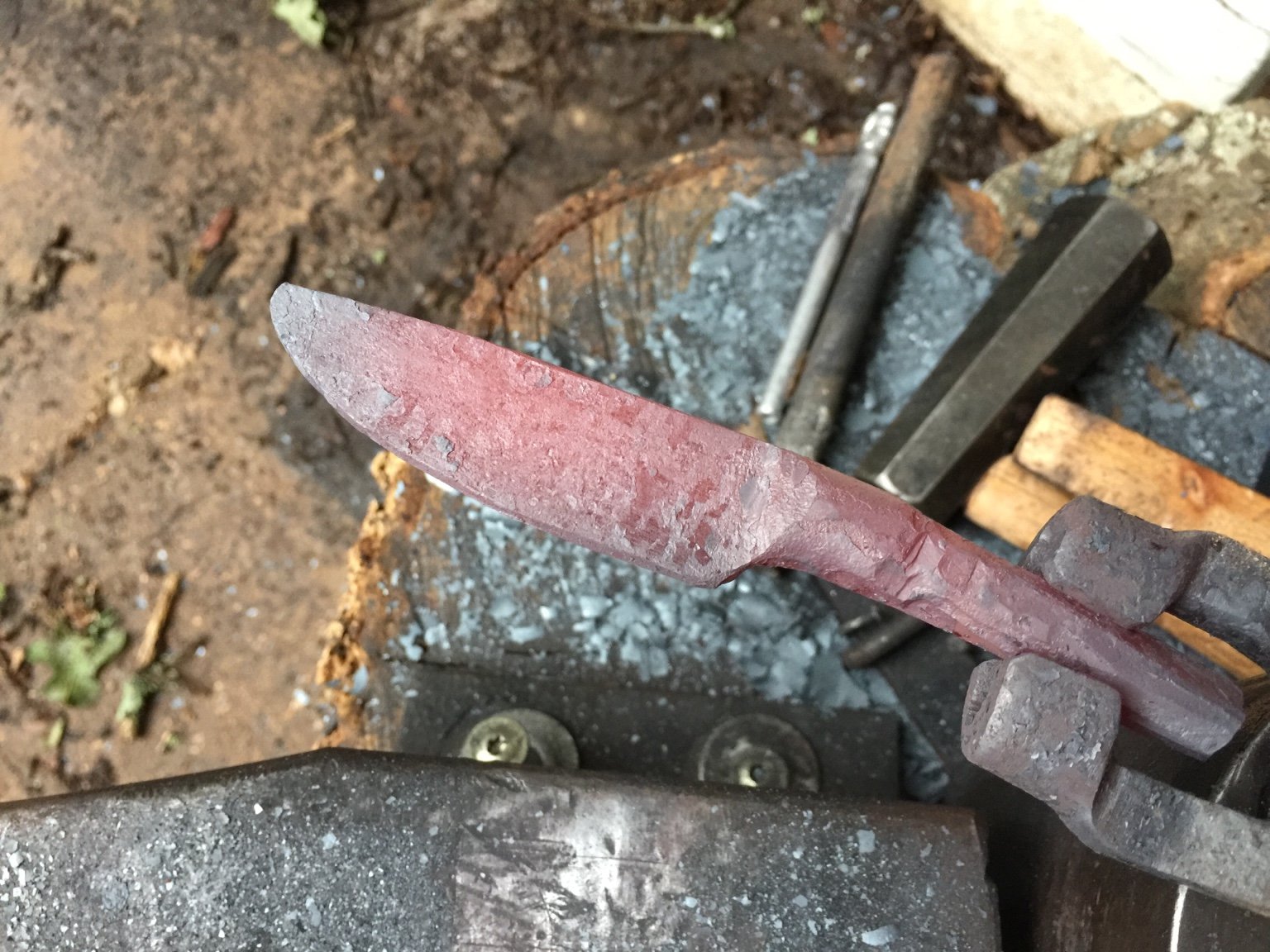

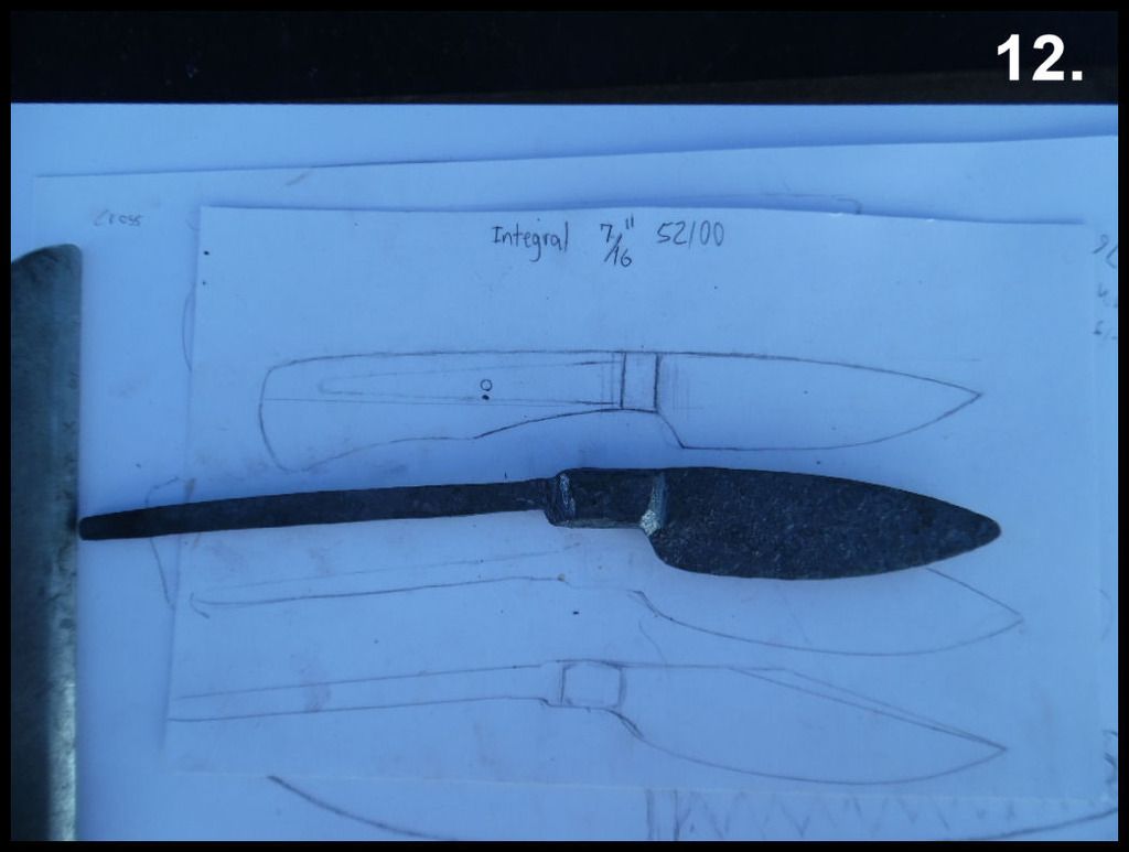

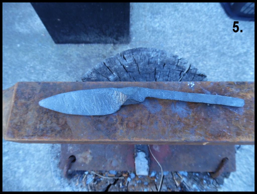

Here's one I forged last summer out of some 7/16" (pretty small stuff, especially for an integral) round 52100 which I upset to around 5/8" diameter as you'll see in the pics below. I then forged it into a square (or diamond) cross section (with rounded corners) in order to forge it on the bias (diagonal/diamond) to get the steel to spread out more, and easier, for the blade width I wanted. This is something I pretty sure that I I learned from reading Tai Goo's blog some years ago, which has really helped me out with getting good width when forging without the help of a power hammer etc. This is the technique he uses to get so much width on the RR spike knives he's made.
After I forged it all out on the bias, I just rounded and smoothed things up to get rid of the edges left by the square. I don't have very good forging skills (or grinding skills for that matter ), but I was pretty happy with the way I was able to transform that long skinny stick of 52100 into a decent sized integral knife, considering the small diameter it started out as.. Gotta love forging! :thumbup: ;)
OK, here are some pictures... (Don't pay any attention to the numbers in some of the pictures)
(A comparison of the exact size bar in length and diameter of what I started with on top, to what an identical bar became after upsetting it)
(Another comparison view showing the thickness gained)
(Here it was after forging the blade and tang. You can tell by the pyramid shape of the bolster that it was forged on it's bias/diamond)
(And here it is after cleaning things up during finish forging)

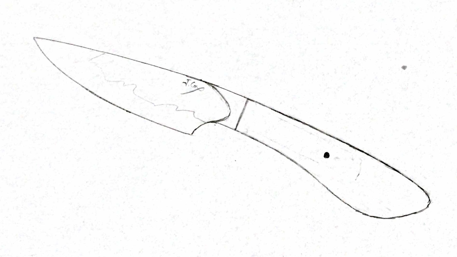

(This one shows is next to the original sketch of the knife I was trying to forge.. I was happy with it :D )

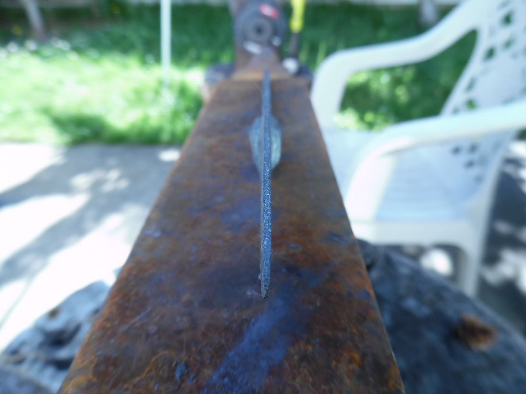

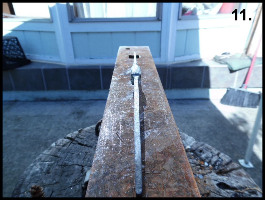

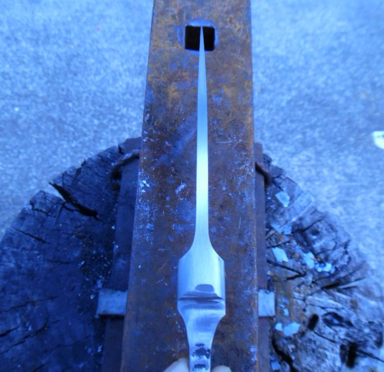

The hardest part of forging an integral (at least for me ) is keeping the blade and tang centered and in line with each other , spine side and edge side. It can become quite tricky at times! :eek:
Here are two pics showing the alignment of the blade and tang on the integral above.
First is with the edge up looking from the tip.
And second is spine up looking from the tang end. (There is a small shadow on the right side of the blade spine which makes it look off center, but it's just an illusion ;) )

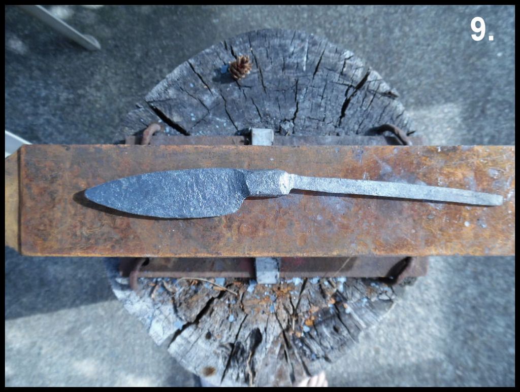

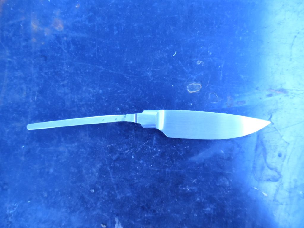

Here is another integral that I forged last summer as well, not that long after the one shown above, except this time I had some "real" steel to begin forging with... Don Hanson's W2 in 7/8" diameter. :thumbup: ... I actually had it the whole time I was messing around with the 52100, but I didn't want to experiment/practice a new technique using such a precious metal.. :D
All of this was done with using only a cheap 2-1/2 lb sledge for forging, a crappy mild steel "post anvil" that doesn't have very good edges on it, or a hardy hole for helpful tooling (I don't forge on that RR track anvil in the pics, it's WAY too loud for my neighborhood), and my single venturi burner propane forge I made from a mail box.
Also, I don't have a small wheel attachment for my grinder or any sanding drums for my dremel to clean up the blade/bolster transition with, and the round & half round file I have didn't do much to the W2 because some are dull and he others are very cheap. So all I did at the time was I just made a makeshift mandrel using some 1/4" round stock with some small rubber hose around it with some sandpaper spray glued around that, which I then chucked into my big old Dewalt hand drill. It definitely was NOT ideal for the job and it made any attempt at being accurate very difficult, but it ended up doing and OK job on that W2 integral. :)

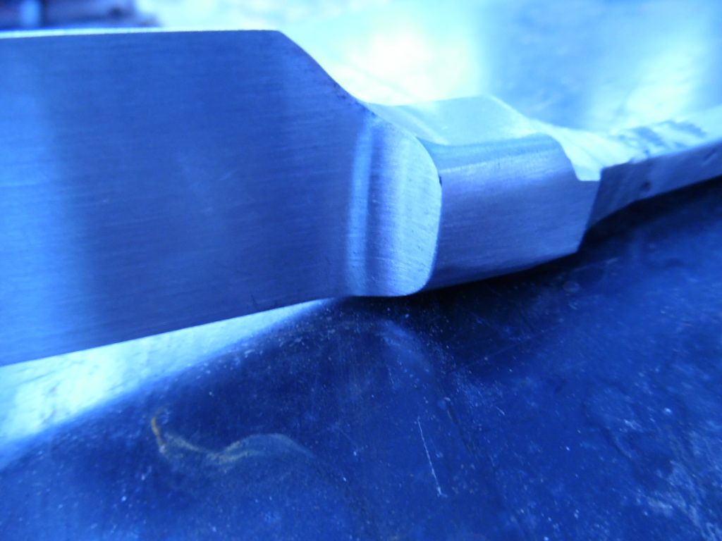

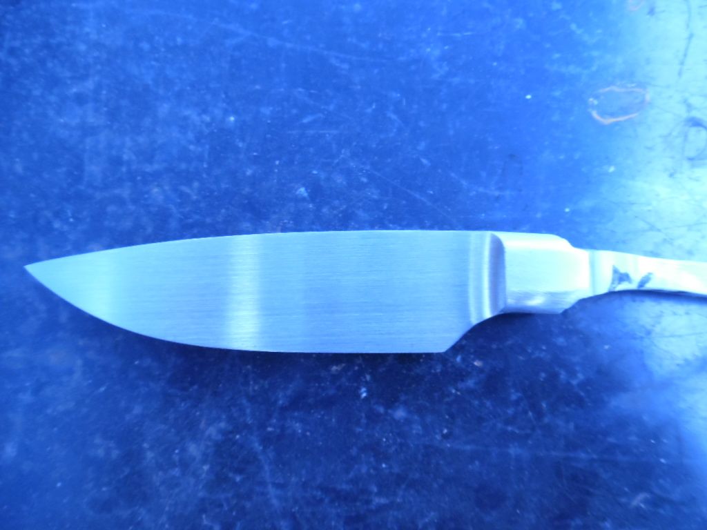

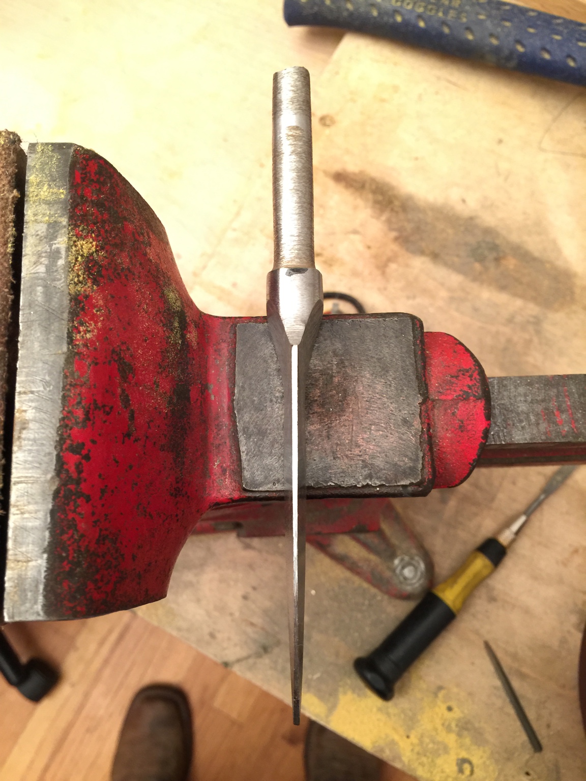

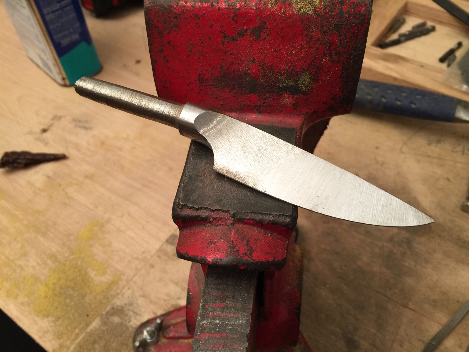

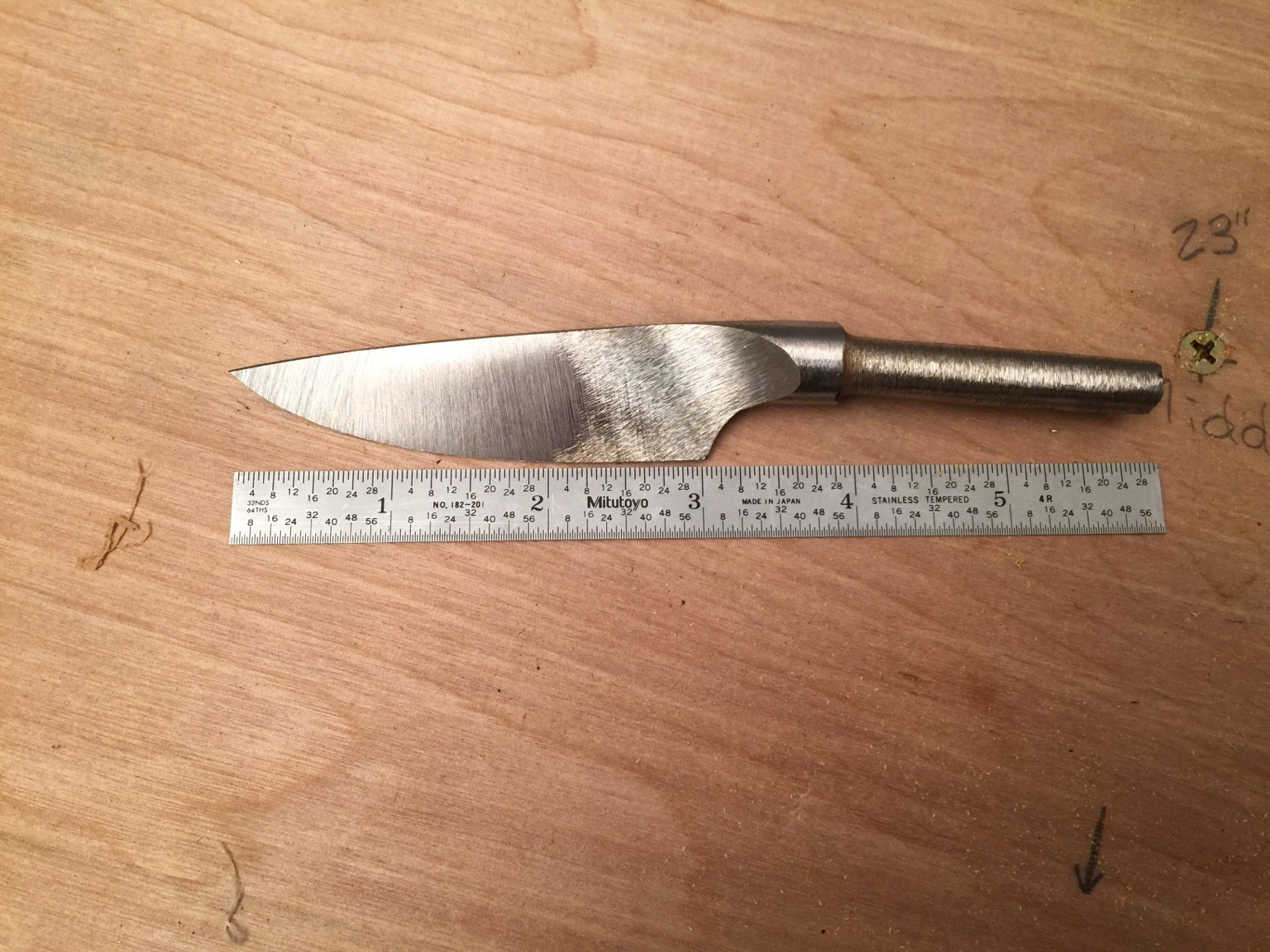

This is how I do integrals.
I use a lot of 1/2-3/4" W1 drill rod for them.
Draw out your blade, whatever shape you're looking for, then cut off the bar a couple inches behind where you want the bolster to finish. Draw the tang out in the style you like. I like a hidden tang, so I forge them round to make the handles easier to do.
I use the idler wheel on my flat platen to shape the transition. Grind the blade, and using the wheel at an angle, blend it into the ground flats being careful not to dish out the bevels, and grind down your tang to the rough size you want.
Do up a good sketch to make sure you're following a plan that will produce a good looking knife.
These pics are all pre heat treat. After heat treat, finish out your grinds in the same manner. You can pretty easily square up the tang shoulders at the bolster by chucking it up in a drill and using it as a lathe with a file, gets a nice square shoulder to butt up against your handle. Cut a cross slot in the tang for your pin to go through, notch the tang to hold epoxy, and glue it up.

El Mucho, that is a nice forging example--I think I'm a good ways from forging that well to be honest--I'm not sure I follow you when you say use your drill like a lathe and square up the shoulders with a file--are you chucking up the round 'billet' in the to be tang zone to turn?
Thanks for the pics and your input brother.
