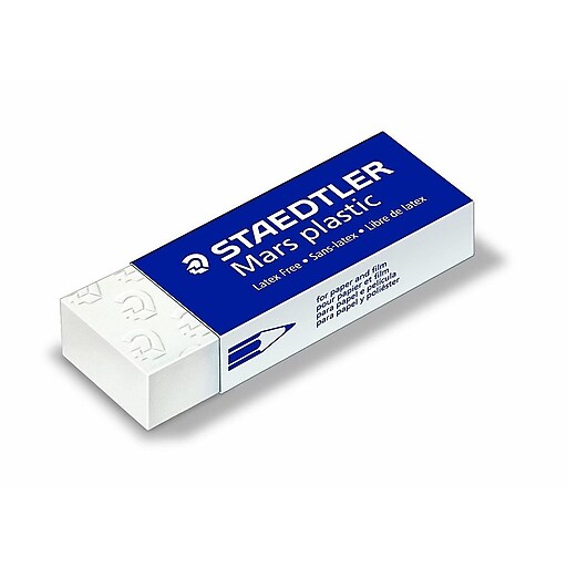

Get an 18X24" pad of 1/4" grid drafting paper. Draw multiple sketches on the same page. You can draw the handle three or four wys until you like it, etc.
Get an 18" steel rule, French curves, compass, protractor, micrometer, etc. A really useful tool is a bendable rule called a flexible curve ruler. Use drafting pencils, not ink. Get a good eraser.
A set of shape templates may be nice. They have circles, other geometric shapes, lines, curves, etc.
Don't scribble out sketches you don't like. Just draw a new one and leave the old ones for comparison.
